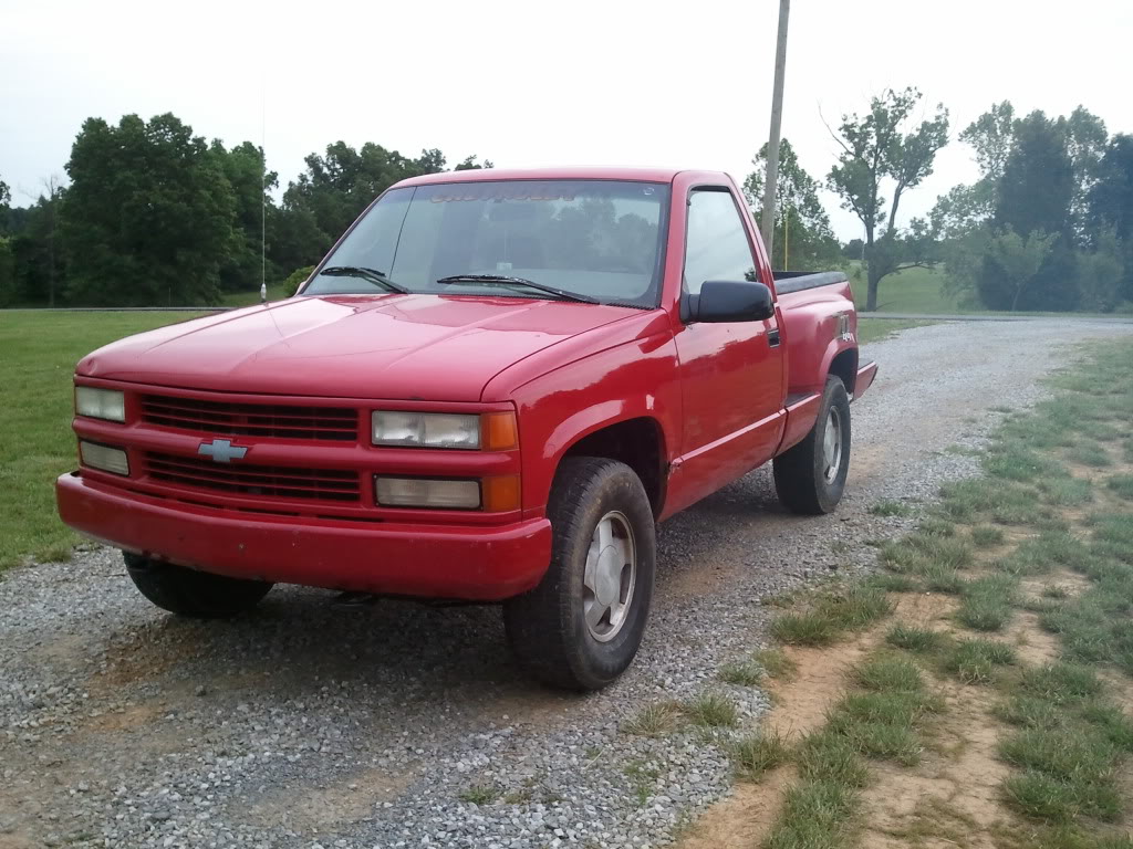

First of all, glad to be on here. Seems to be a place for good info! I bought a 1996 Chevrolet Step Side yesterday. Has 138,000 miles on it. Paid $1800 for it. Runs great and drives great! Having a problem with the 4wd. The guy said he put a new solenoid for the 4wd in it. (Its a push button 4x4) When we was driving it and testing everything out, we tried the 4wd out. We stopped, put it in neutral, and pushed the 4 high button. The light quickly switched over. Then we tried 4 low, and we felt it gear down. Then put it back in neutral and put it in 2 high. So we figured it worked. This morning, I put it in both 4 high and low. Neither would work. But the lights would stay on the buttons like they should. So whats going on? Thanks in advance
Here is a pic of the truck
