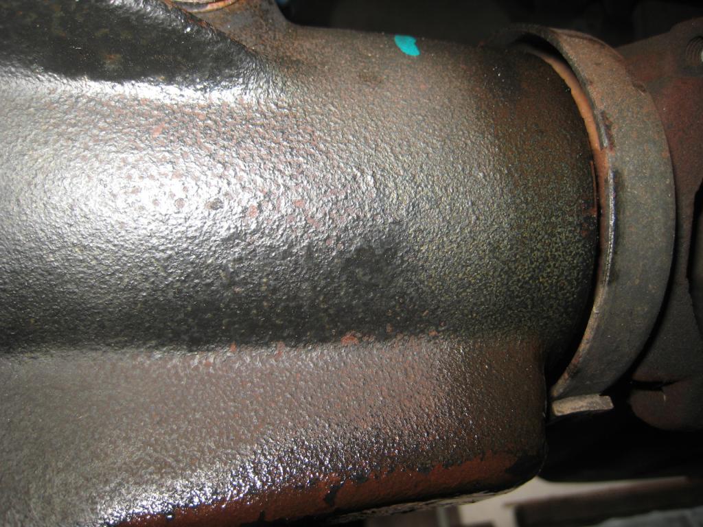

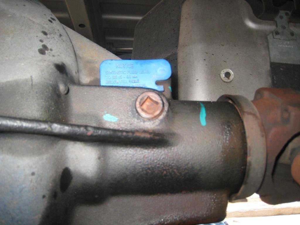

I just recently changed the fluid in the rear differential of my truck and unfortunately the next day I noticed it was leaking. It appears as if it is leaking from the seal because the housing is dry. I changed the fluid using Mobil 1 75w 90 gear oil and I replaced the gasket and used black rtv sealant. Anybody have any ideas? My truck is a 2001 Silverado 1500 LS 5.3L 2wd. It has the GT4 differential. It asked for 2 1/4 quarts and I may have put in slightly more than that, but not by much. It was still under the fill hole and the additional amount wasn't much.

The fill hole is also the spill hole. When the oil starts running back out, it's full. Could be your level was low with the old oil, and being up close to the right level now is showing a leak that you already had.

looks to me like a pinion seal gone bad. ive seen it happen before when people change the oil after it hasnt been changed for a while it cleans out the dirt and grim around a seal causing an old leak to show up. that dirt and grim use to plug the seal. ive only seen it a few times though

I think you guys are right and that is what I was afraid of. My truck has 138k miles on it and this was the first time I changed the diff fluid so I'm not surprised this happened. I guess I will have to look into replacing the seal. I've looked into it a little bit and I hope the job isn't beyond my means.
