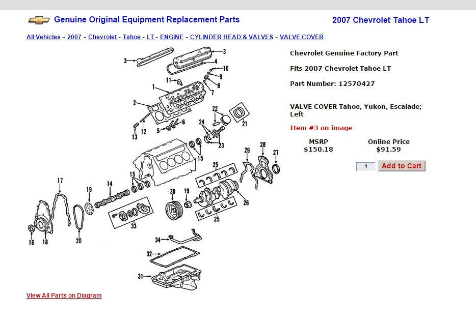

I was going to order the parts for my AFM engine but when I put in part# for the valve cover (12570427) it says that part won't fit a 2007 AFM Tahoe. It says will fit avalanche but not Tahoe. Also was CheapestGMparts web site. I might be understanding it wrong but I absolutely don't want to buy the wrong part. It just takes to long for returns Etc......... Any thoughts anyone? 2007 Tahoe 5.3 AFM Flex fuel 4x4.
Old Aug 7, 2015 | 9:47 AM
  #47
Likes: 48
12570427 is what I find listed on GM parts direct site for the 07 Tahoe....
Amazon has it listed but does not specify what vehicles it fits, however you could ask the seller to confirm the fit via your VIN...
I think it is the correct part... as I have it in my Amazon cart for my 07 Tahoe.. Im not seeing the consumption issues since disabling my AFM so I don't think I am having any issues with the PCV at this time...
