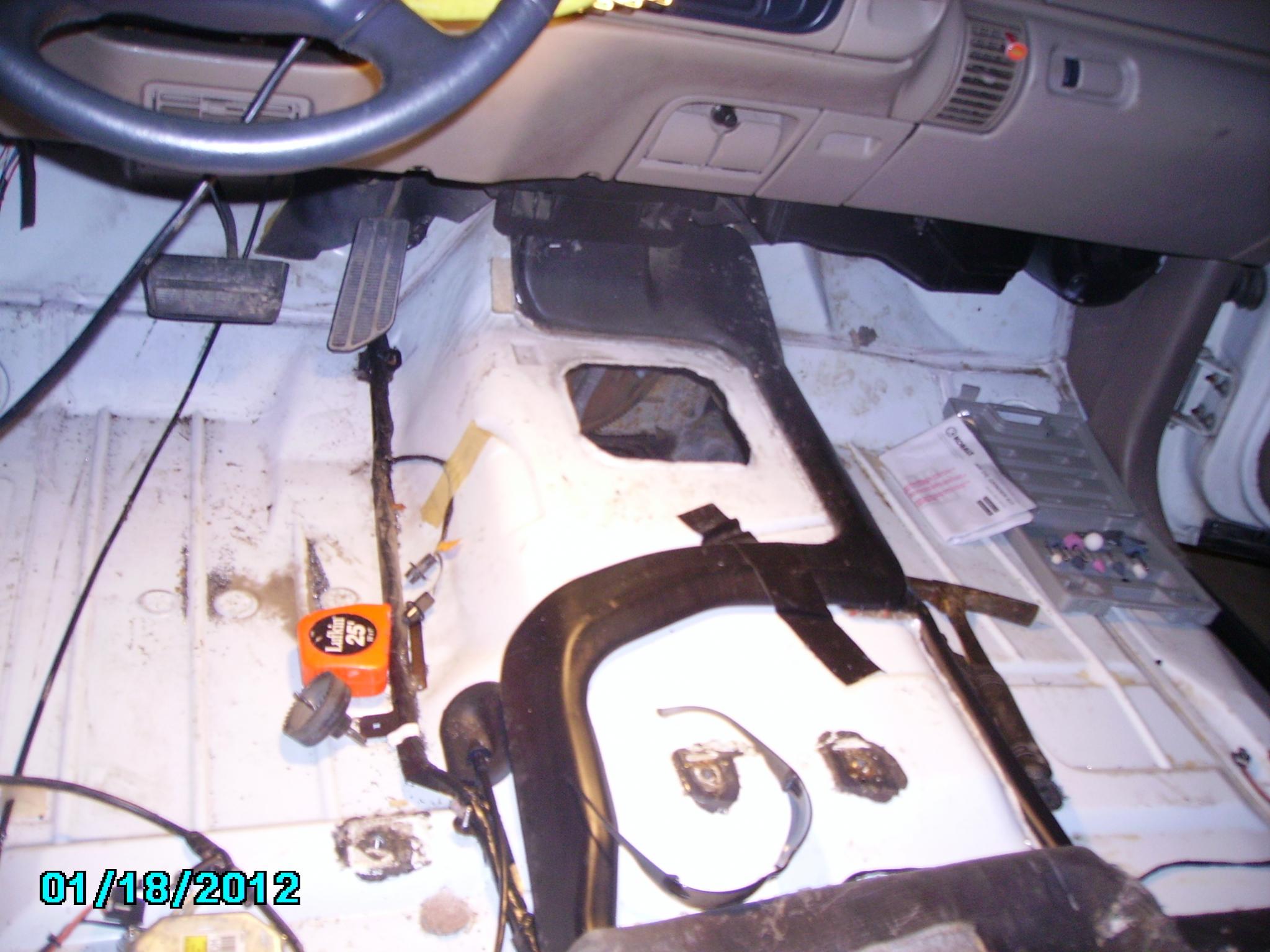

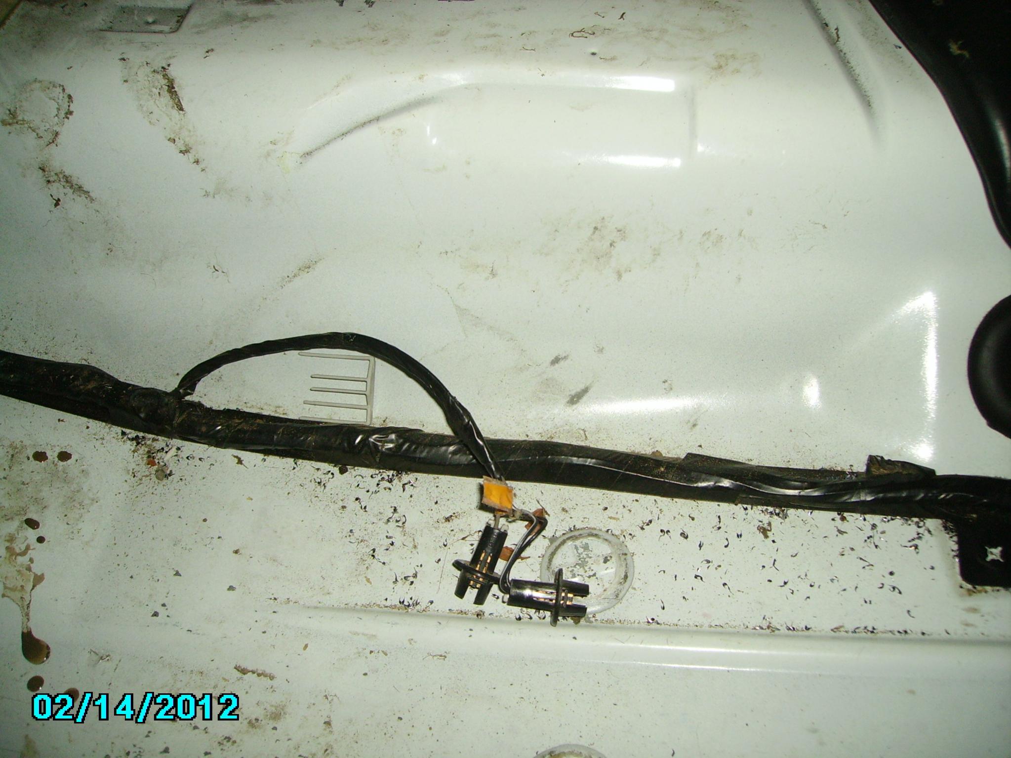

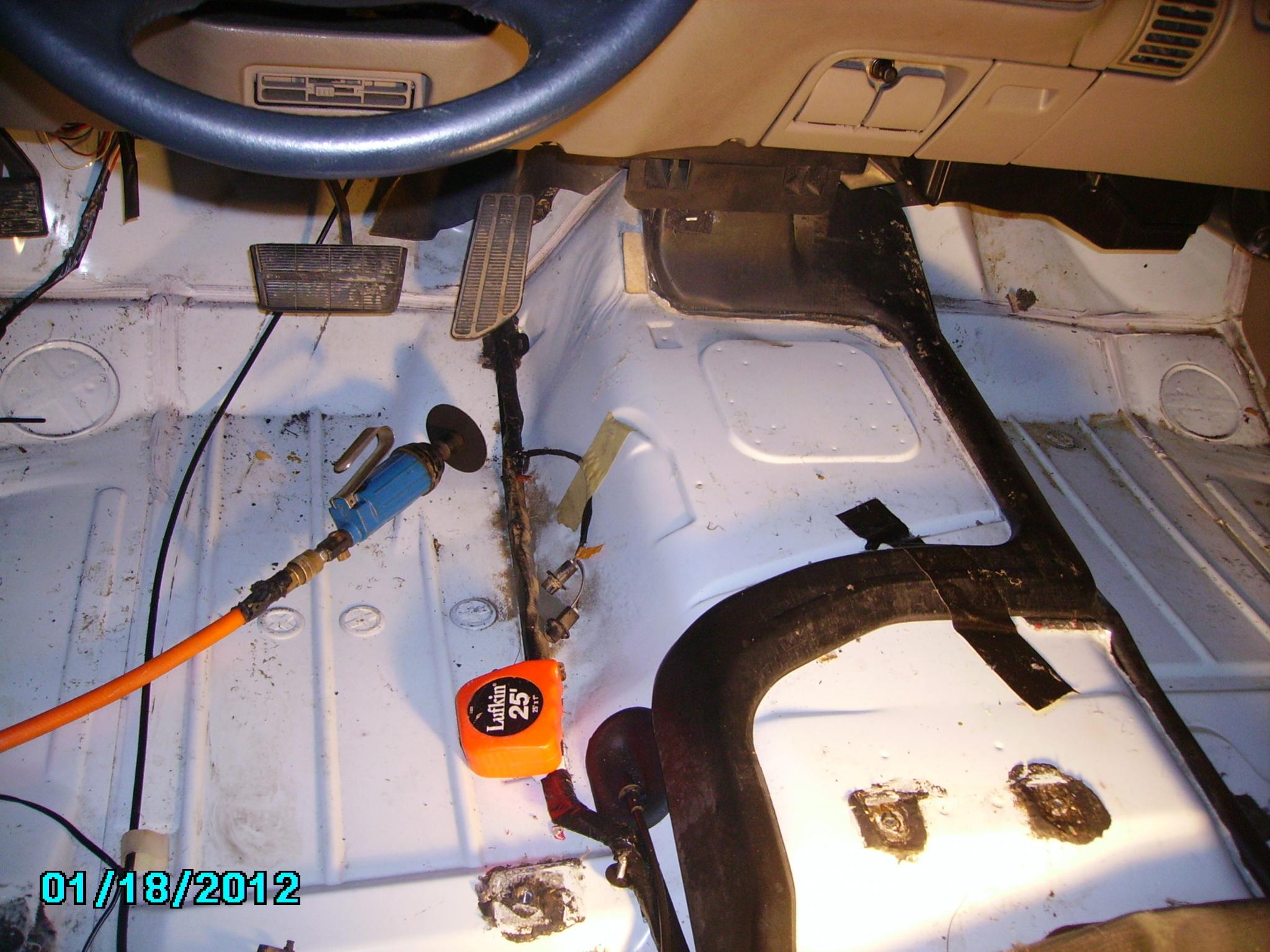

Default Clutch pedal Installation
Here's the pics of the clutch pedal installation.
Attached Thumbnails 1998 tahoe 5 speed swap-pict0391.jpg   1998 tahoe 5 speed swap-pict0392.jpg   1998 tahoe 5 speed swap-pict0395.jpg

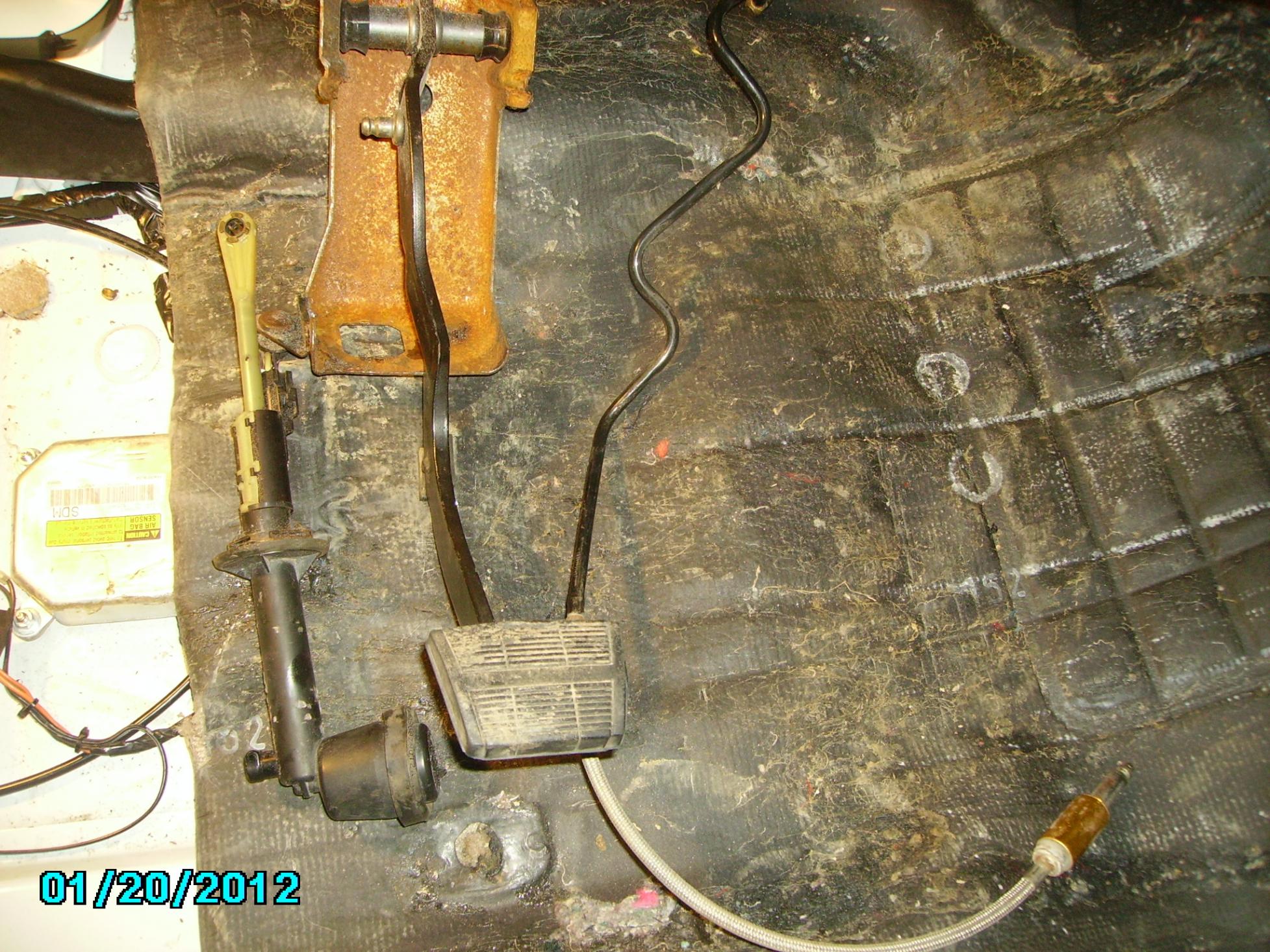

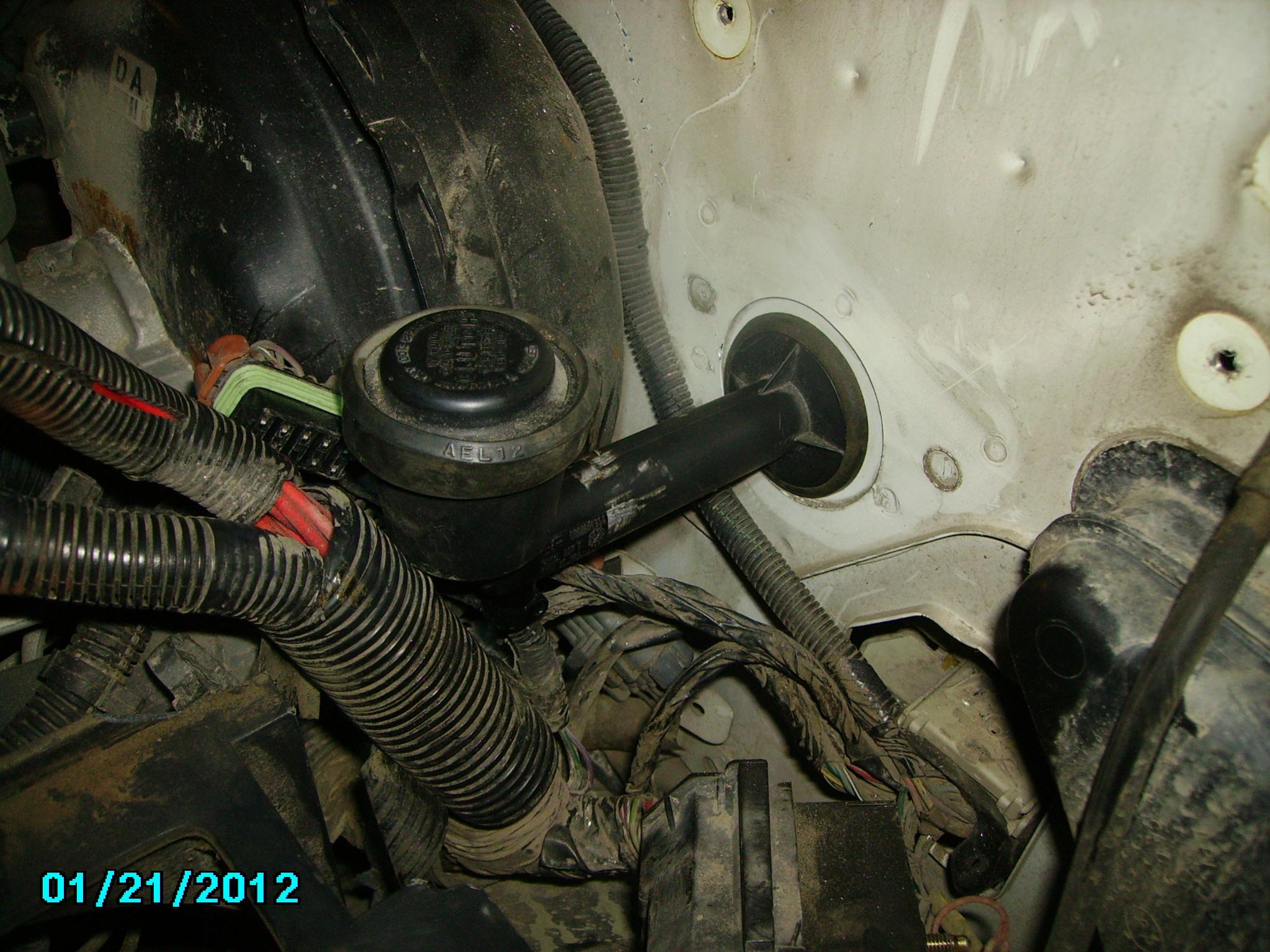

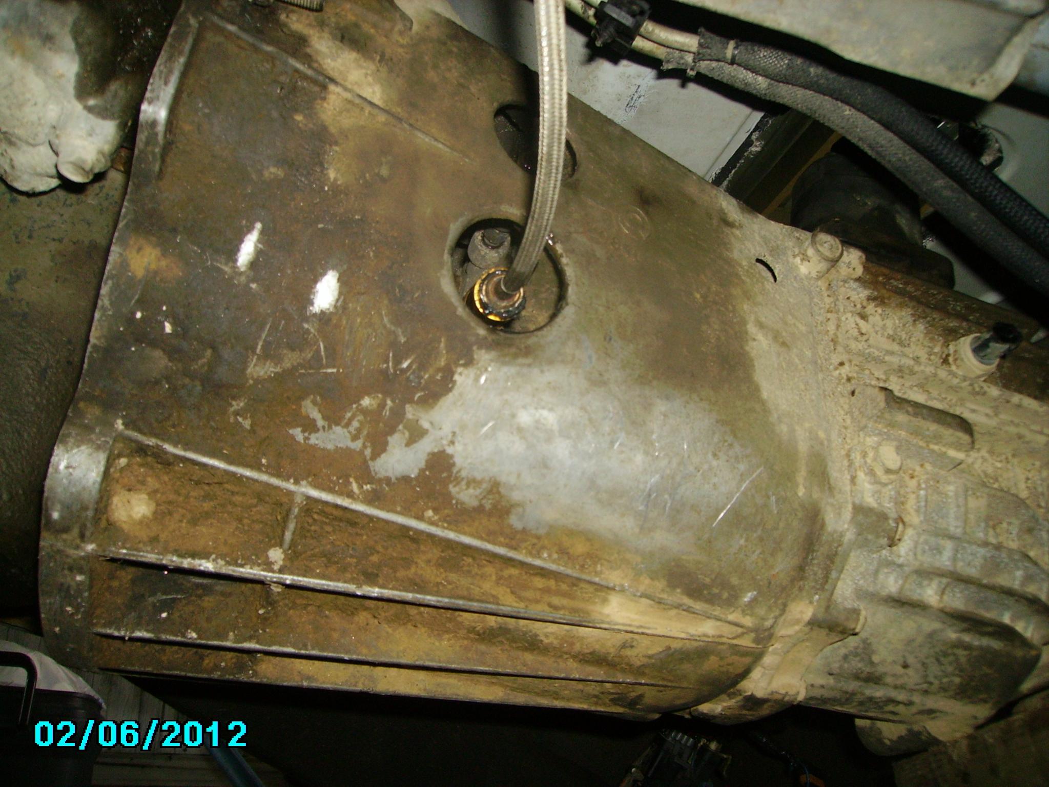

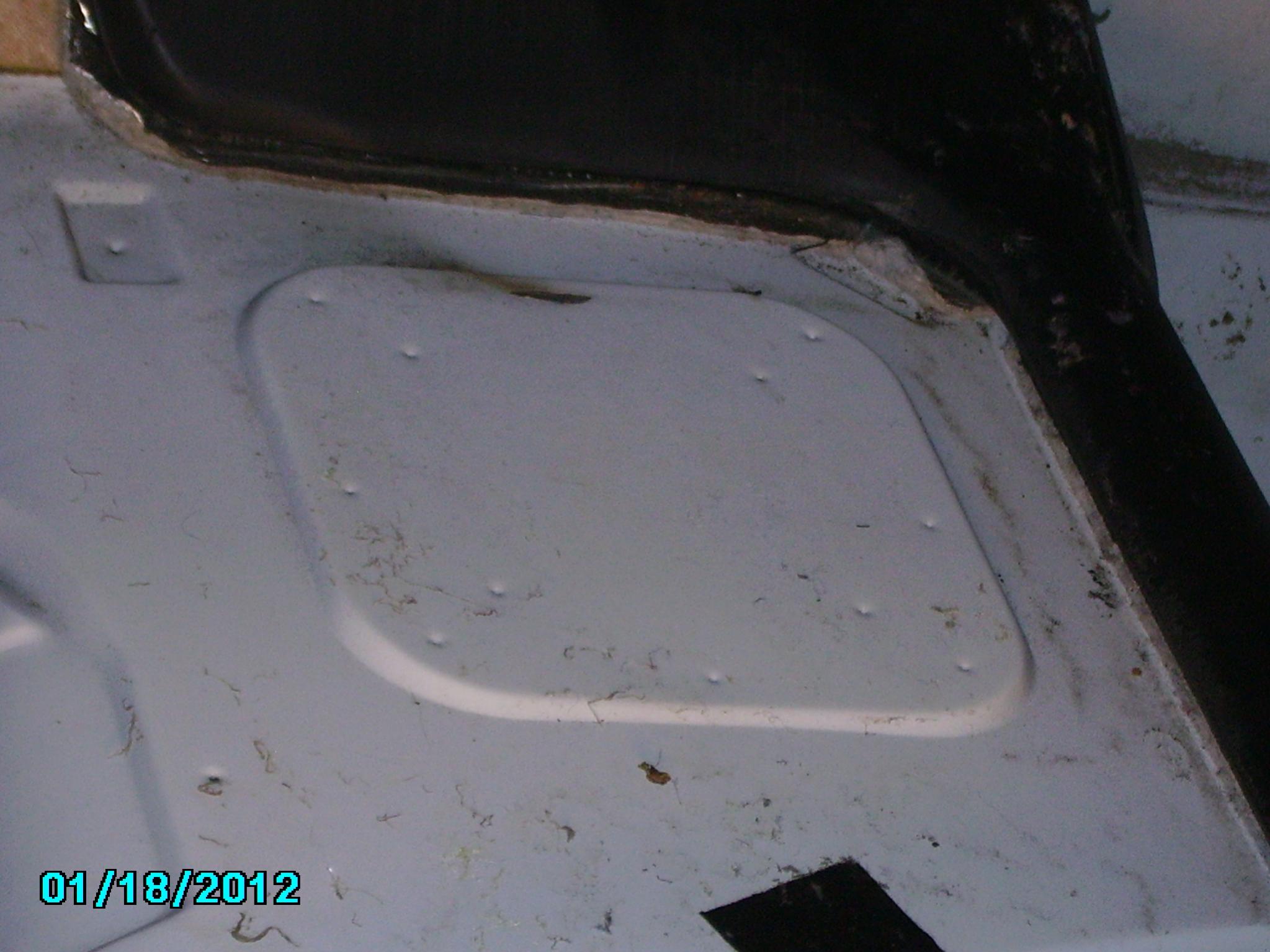

Default Clutch components
Here's pics of the installation of the other clutch components: cutting the hole for the shifter, and installation of slave cylinder.
Attached Thumbnails 1998 tahoe 5 speed swap-pict0388.jpg   1998 tahoe 5 speed swap-pict0389.jpg   1998 tahoe 5 speed swap-pict0390.jpg   1998 tahoe 5 speed swap-pict0393.jpg

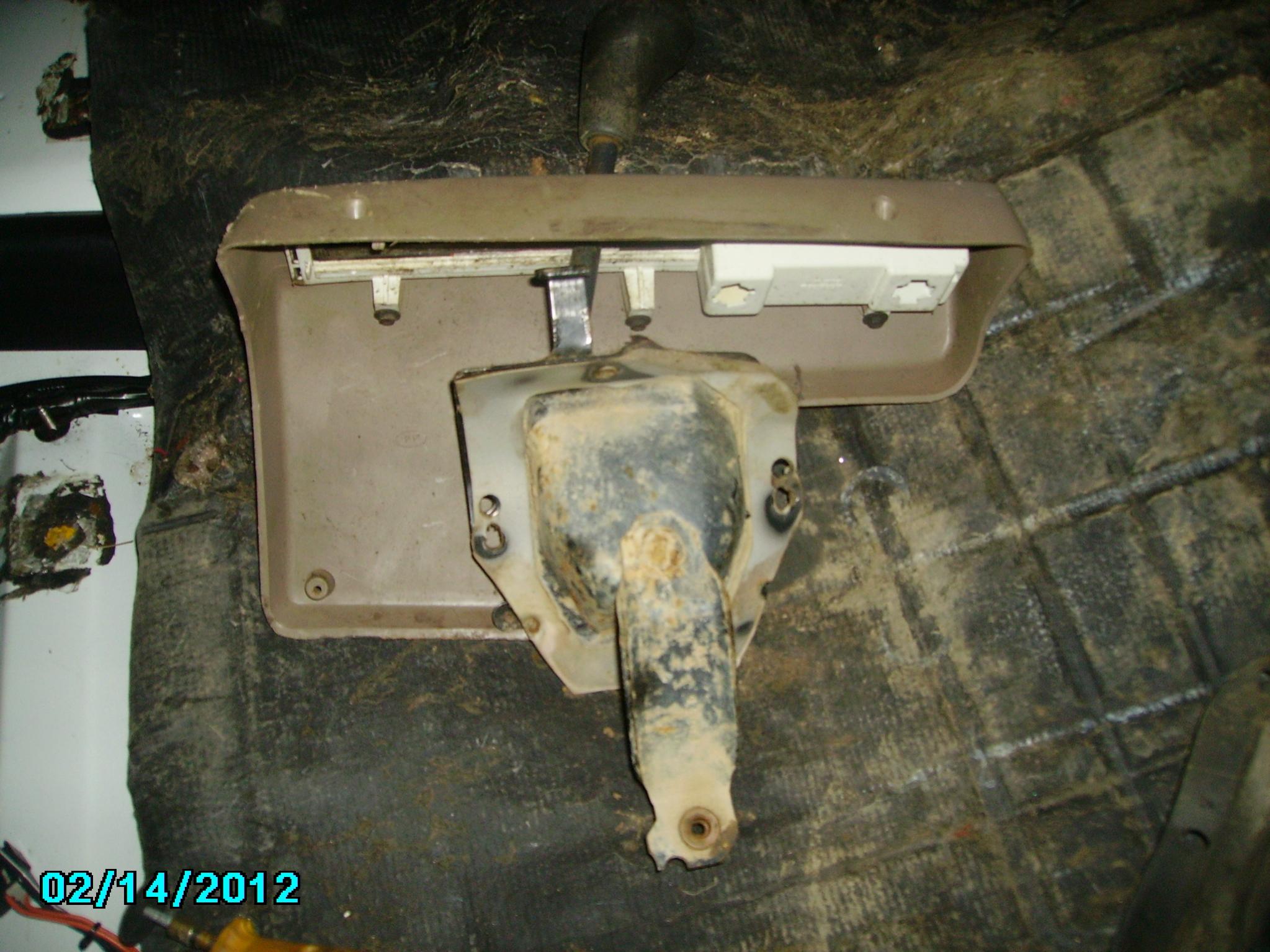

Default Clutch component install part 2
Slave cylinder completion and clutch pedal installation completion.
Attached Thumbnails 1998 tahoe 5 speed swap-pict0396.jpg   1998 tahoe 5 speed swap-pict0397.jpg   1998 tahoe 5 speed swap-pict0398.jpg

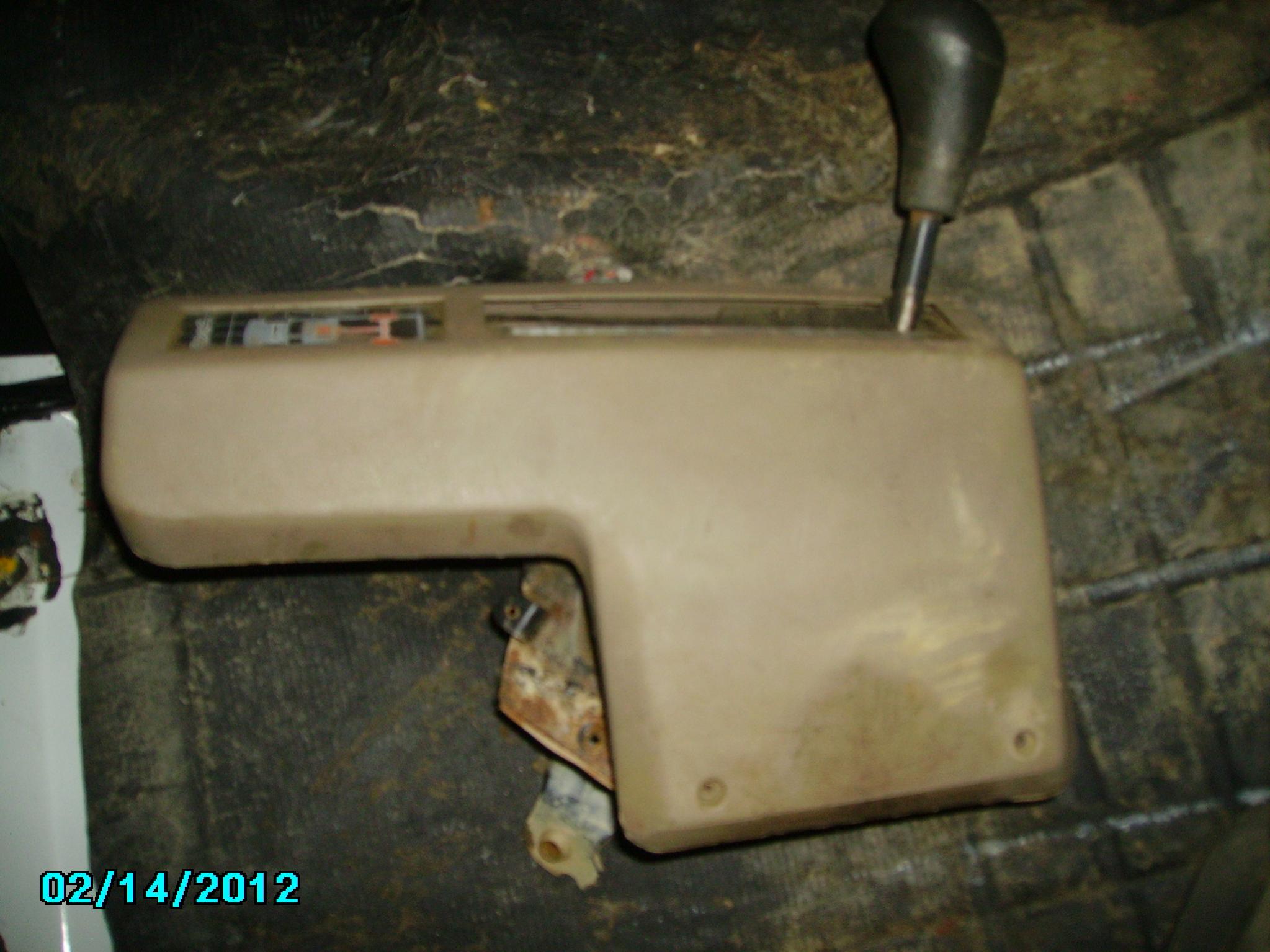

Default Transfer case install
241c Transfer case installation and shifter
Attached Thumbnails 1998 tahoe 5 speed swap-pict0745.jpg   1998 tahoe 5 speed swap-pict0750.jpg   1998 tahoe 5 speed swap-pict0751.jpg   1998 tahoe 5 speed swap-pict0752.jpg

Default Transfer case completed
Completion of transfer case installation.
Attached Thumbnails 1998 tahoe 5 speed swap-pict0755.jpg   1998 tahoe 5 speed swap-pict0756.jpg   1998 tahoe 5 speed swap-pict0757.jpg

Seats and console have been re-installed and clearance of the shifter is good. Overall it was a learning experience, hopefully it will be easier the next time. Hope this helps anyone wanting to try it themselves. I will try to answer any questions if you have them, to the best of my ability. Thanks!
