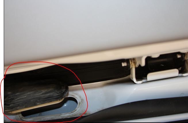

If your leak is at the rear roof , the pictures in the above post will show you the boot that is leaking.
Is this the one u sealed?

Likes: 48
Yes, didn't seal it though, cleaned and applied silicone grease, if boot is properly installed it won't leak.
