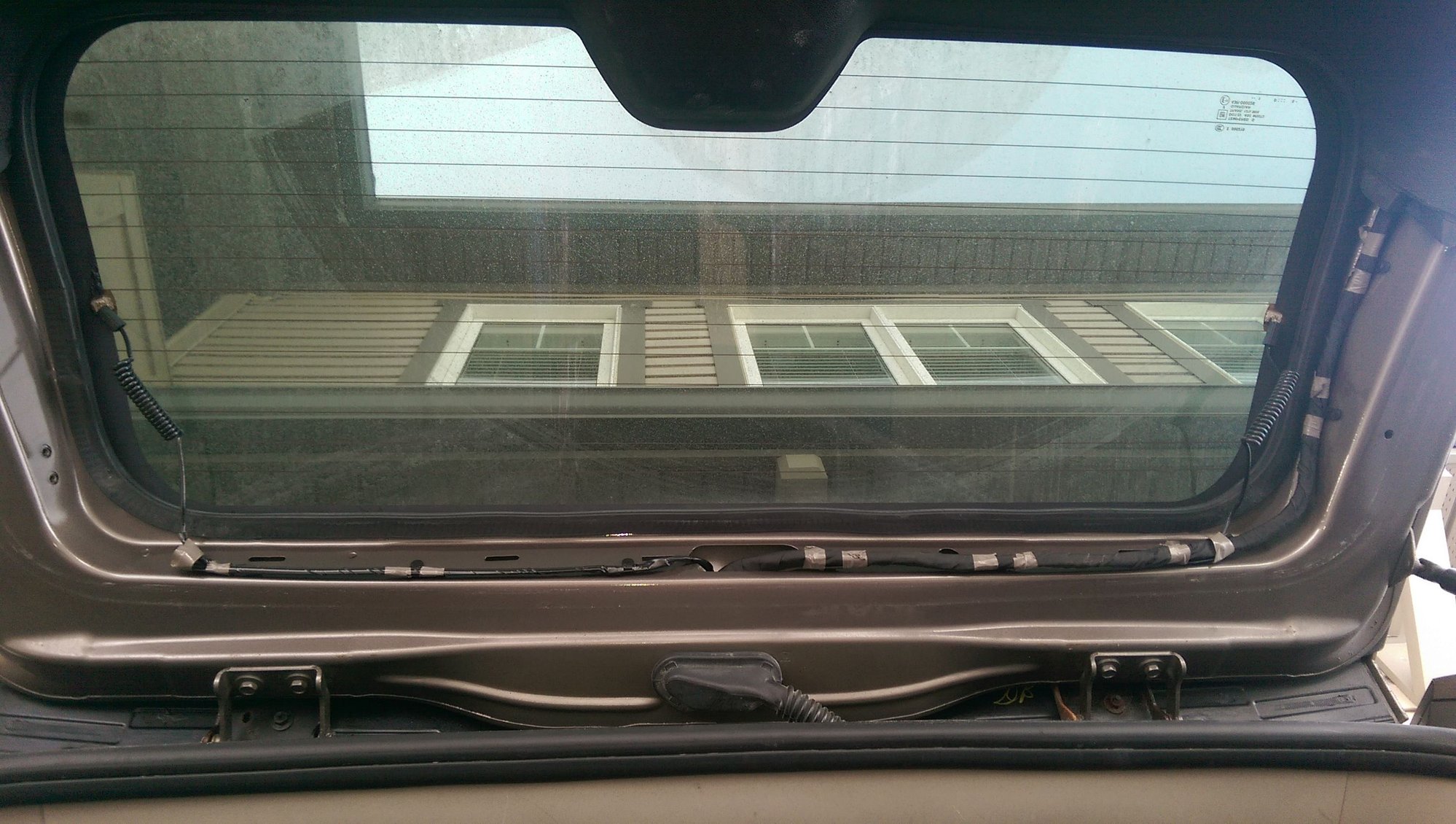

Thanks for the replies folks. The problem was latch release switch... GM part 15106857- Rear Liftgate Latch Release Switch.
Cost me 30$ at local dealership and about 1hr of my own time to figure out how to remove rear panel (it's all a series of clips that come apart) then there are 4 bolts on the interior that kept the handle secure - those need to be removed so the handle can come off and then switch replaced.
See some pics of the work for those interested.
The upper trim is the first piece to be removed. It's connected by a series of clips
Main rear panel removed. There are only 2 screws to remove, one under where the handle is and where the strap is.
Interior trim panel held by a dozen or so clips.
Here's the culprit...
