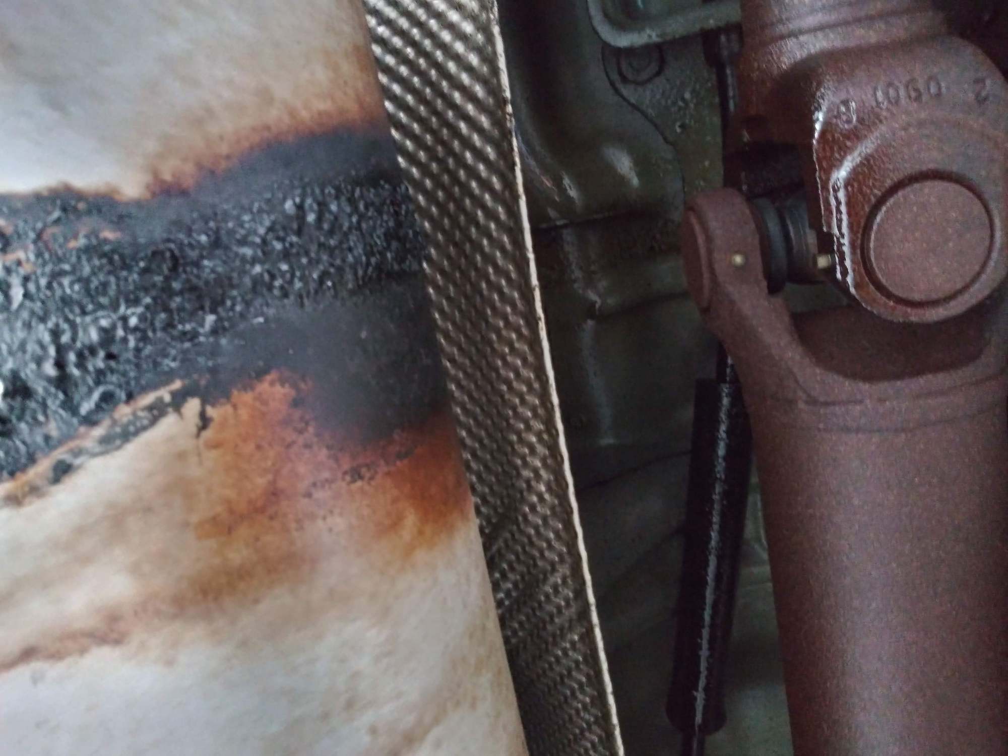

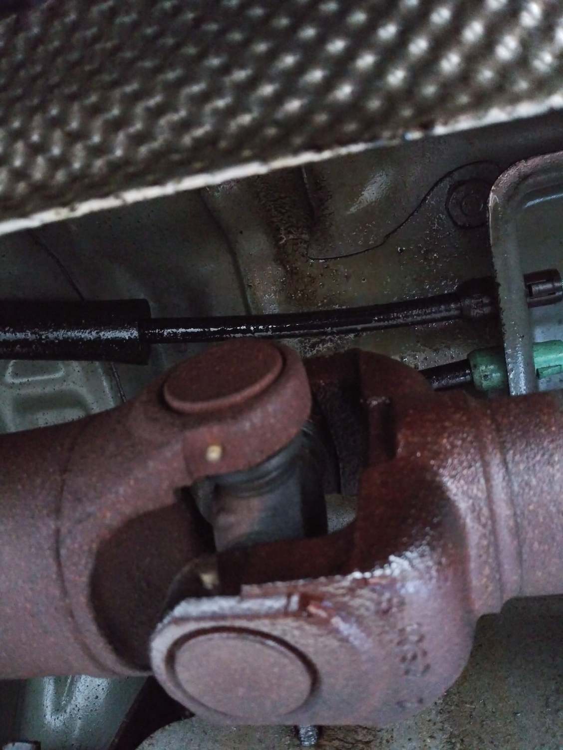

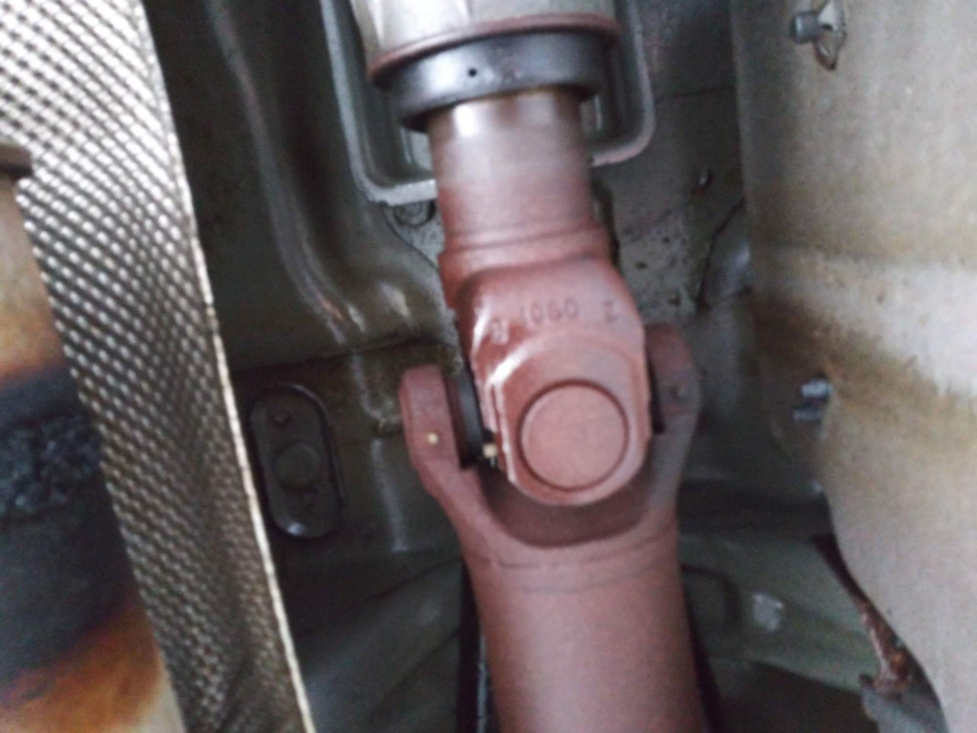

hey guys, 1st post here. hoping to learn from this forum as well as provide any info from my experience with gm vehicles. haven't run across this specific issue i'm having on mine. i have an 07 tahoe LT 2WD 5.3 w/225k miles. i stopped driving it because i started using another vehicle for work. no issues at all before parking. i would start up (no drive) once a week. after a few weeks i noticed a bad trans leak at the driveshaft / u-joint area. leaks when vehicle is not running and has leaked quite a bit. not sure exactly what parts i need to repair correctly. any help would be greatly appreciated

its leaking out the center of the slip yoke. you need a new slip yoke

the ujoint is held in with plastic...it has to be melted out...use a torch and it will run out the 2 holes that can be seen in the picture. the new slip yoke will be secured with clips...make sure they come with the slip yolk.
