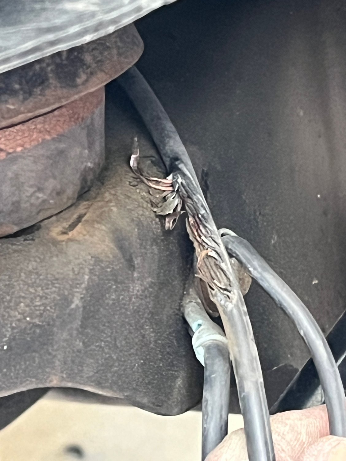

UPDATE / FIXED:
Hey all - I wanted to follow-up here and let you know I'm pretty sure I've solved this. After posting here, I did a lot of research online and learned there are a lot of GM owners that have had this issue. The short story is that the negative battery cable has a way to getting pinched and fraying. The negative line comes off the battery post, and has has two lines: one that grounds to the passenger side of the motor on the front of the head. The other line runs up to the front and attaches to the frame. Huge PITA to get to and you have to take the front bumper off to access it.
And sure enough, mine was pinched and frayed too! I'm been driving for a few months now and haven't had the car stall, or hear the door lock flickering, as I'd go over rough road. Anyway, thought I'd post here and let you know all.
Notice the ground lead routes inside the body mount.  Lame.
Rerouted lines outside the body mount point.
Cleaned and tight.
Cleaned and tight.
Below is the YT vid that really clued me in this issue. I ended up replacing the positive and negative lines, just to be sure. You'll see it in the first 60 seconds.

No. The Burb would run just fine. Then we'd hit a pot hole or speed bump, and the door locks would cycle. Sometimes, the car would go into a 'limp mode' where the RPMs would drop. Even if I went WOT, the RPMs wouldn't go over 2k and she'd stall in about 7 seconds. The car was doing this for 6 months. I went to three different mechanics (referrals) and nobody could get it to repeat. I'd pick it up and with them not being able to find anything wrong, and then the same thing would happen again in a few days or a week.
Finally I just dedicated an entire evening to going thru vids on YT and reading other Forums. Turns out there is a lot of content on this, and it's apparently pretty common with GM trucks and SUVs. In one evening I narrowed this down to the POS and NEG battery cables and ordered replacements from RockAuto.
Replaced them both and it's been trouble free. The biggest shock to me though is how these 'professional' mechanics, two of which was GM specialists, couldn't figure this out. Do these people never open a laptop and research anything?! Somehow, a software sales rep (me) had to figure this out on his own, and did so in one evening.
