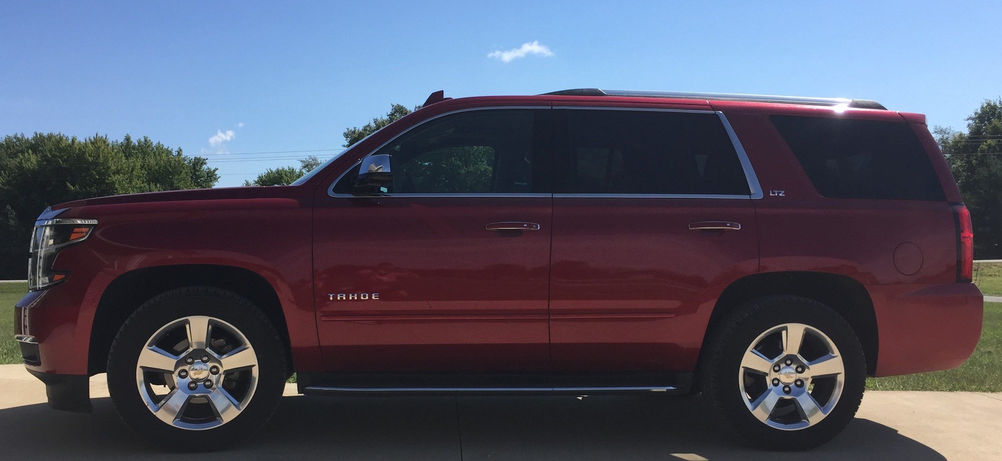

I'm just chiming in here because this is one of the few active links remaining on this topic. I recently acquired a 2015 Tahoe LTZ on a good deal (Out of Warranty) and noticed the ride being a little bumpy during the test ride but was told that they had recently reset the computer and it would take time for it to re-calibrate and learn the road/driving habits etc...Sounded plausible enough at the time but as time went on and the ride failed to improve, I went googling around the internet and found there are issues with the ride among other things with the LTZ's Denali's and Cadys... Well, some of these particular autos have the Z95 option suspension. If you have that code on the sticker in your glove box then you might have the same problem.

First of all, my ride is stiff. It just felt like every bump I hit was NOT being absorbed by the springs and the shocks didn't seem to be damping the effects of the springs as they were intended to do. So a jolt from the rode would come directly up through my spine and a crash back down with no sign of relief. The front seemed low about 4 1/2 inches from the finder to the tire and the rear was closer to 7" from the finder to the tire.
a. I changed the tires, because it needed them anyway - it did nothing for the ride. 20" wheels stock size tires (DID NOT WORK)
b. I tried to create a Magride sensor spacer for the front. The idea was; if you make the computer think it has a lot of weight on the front, it will electronically increase the dampening of the front struts. (THIS WORKED) I'll try to post a pic that was on another site that shows a spacer between the A-frame of the truck and the sensor bracket. I also used a 1 3/4-inch spacer and 6MM X 60MM bolt. The front was much more controllable but the back end was awful.
This may be why there is a problem: When I looked up the springs on the GM website the application is for Tahoe 5.3L, Suburban 5.3L/6.0L, Escalade 6.2L, Denali Trucks. If the springs were designed to hold up a truck with a 6.2L engine then they are probably a little stiff for something with a 5.3L engine.
c. When I moved the sensor on the rear, it didn't work the same. Here's why: The Autoride system has auto-leveling built in. In the event you tow a trailer and weight is placed on the rear of the truck, the air pump increases the pressure in the rear shocks in an effort to compensate for the sagging rear-end. This just made it worse, the springs were too stiff and the shocks were now inflated making is more stiff, if that was possible. (DID NOT WORK)
d. I lowered the rear shocks: WHY? I noticed that when the rear shocks were unbolted they still had spring pressure inside even after I released the air from the shock, you still couldn't compress them without a hydraulic press. If they were providing lift as well as the harsh springs, by lowering them, you essentially take their spring action of the shock out of the equation. This did help some but you didn't have any damping for the rear springs and it was still harsh on the small bumps and bouncy on the big ones. (DID NOT WORK) But I did learn that it was the springs that were too harsh regardless of whether the shocks were in place or not. I looked up the springs and they are AAS2 type springs used on many Tahoe's, Suburban's, and full size trucks. Again, the Tahoe is the lightest of the class of vehicles to use these springs and would be impacted the most by their harsh ride.
e. I lowered the rear: WHY? There were several reasons:
-1. With stock suspension, the rear was 2 1/2 inches higher than the front, not sure why, it’s just the way they make them.
-2. I wanted to get rid of the stock spring because it appeared to be the problem.
-3. If I put more weight on the shock, I thought it may ride better.
I ordered 3" lowering springs, I really didn't need to lower it 3 inches but I also knew the shock would take some of the load so if it went down 2 1/2 inches, it would be level anyway. These kits often come with lowering shackles for the shocks....I did NOT get them because I wanted the shocks to take some of the weight....If I would have lowered the shocks, it would have lowered the full 3 inches. Remember the Auto-Leveling system would compensate for any lowering of the rear by inflating the shocks with more air....So, to counter-act this, I made a bracket from flat metal and bolted it to the existing bracket; then I drilled a hole 1" lower than the original, thereby lowering the rear Magride sensor 1" (THIS WORKED) This is the outcome: It lowered the rear 1 3/4 inches and it placed more weight on the shocks, it rides incredibly smooth in the rear.
I was almost thinking about using 1" lowering springs on the front with a one inch lift kit just to get rid of the factory springs (haven't done this yet).
Truthfully, I don't think there is anything wrong with the MAGride system, I think they just went too heavy with the springs. I had to fool the Magride on the front to get it to compensate for the stiff springs, if I swap the springs in the front with aftermarket items, I could probably just leave the Magride alone. I haven't pulled a trailer or anything but NOW I don't mind paying the payment for the ride I get! I've seen horror stories about the dealers having these vehicles for 27 days of first 36 days of ownership; it did take a while to do all this but it was an extra vehicle, not a daily driver so I had time to work with it and tweak things in. The rear springs were $130 on eBay and they really only took 15min to put in; WAY easier than I thought, look up a YouTube video on it. If you have jack-stands and some metric tools, you’re in business. Rather than making extension or lowering brackets for the Magride sensors they also have longer and shorter rods you can install; they sell them where they have lift kits and lowering kits, but you have to know exactly what length you need. I also know that not everyone may be able to do this but if you're footing the bill, you may be able to have someone handy or a local shop do this for you rather than paying $3500 in diagnostic fees to help GM figure it out.
GOOD LUCK!
