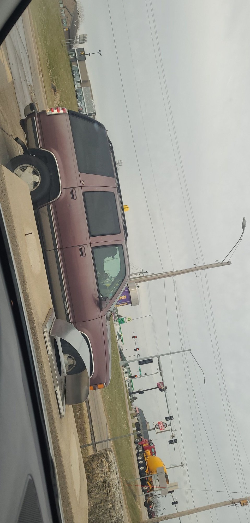

Hello i have an issue that my 3 brake lights do not work. I have tail lights, and hazards working but nothing occurs when i hit the brake pedal. I went to get a brake lamp relay for the fuse box because i looked and it was missing? But there is absolutely no connectors there to click the relay into ? I also replaced fuse 1 inside the vehicle.
i just bought this vehicle for next to nothing for a winter beater
if anyone knows if theres anything else i should look at or do i have to buy a whole fuse box?
Pictures included
