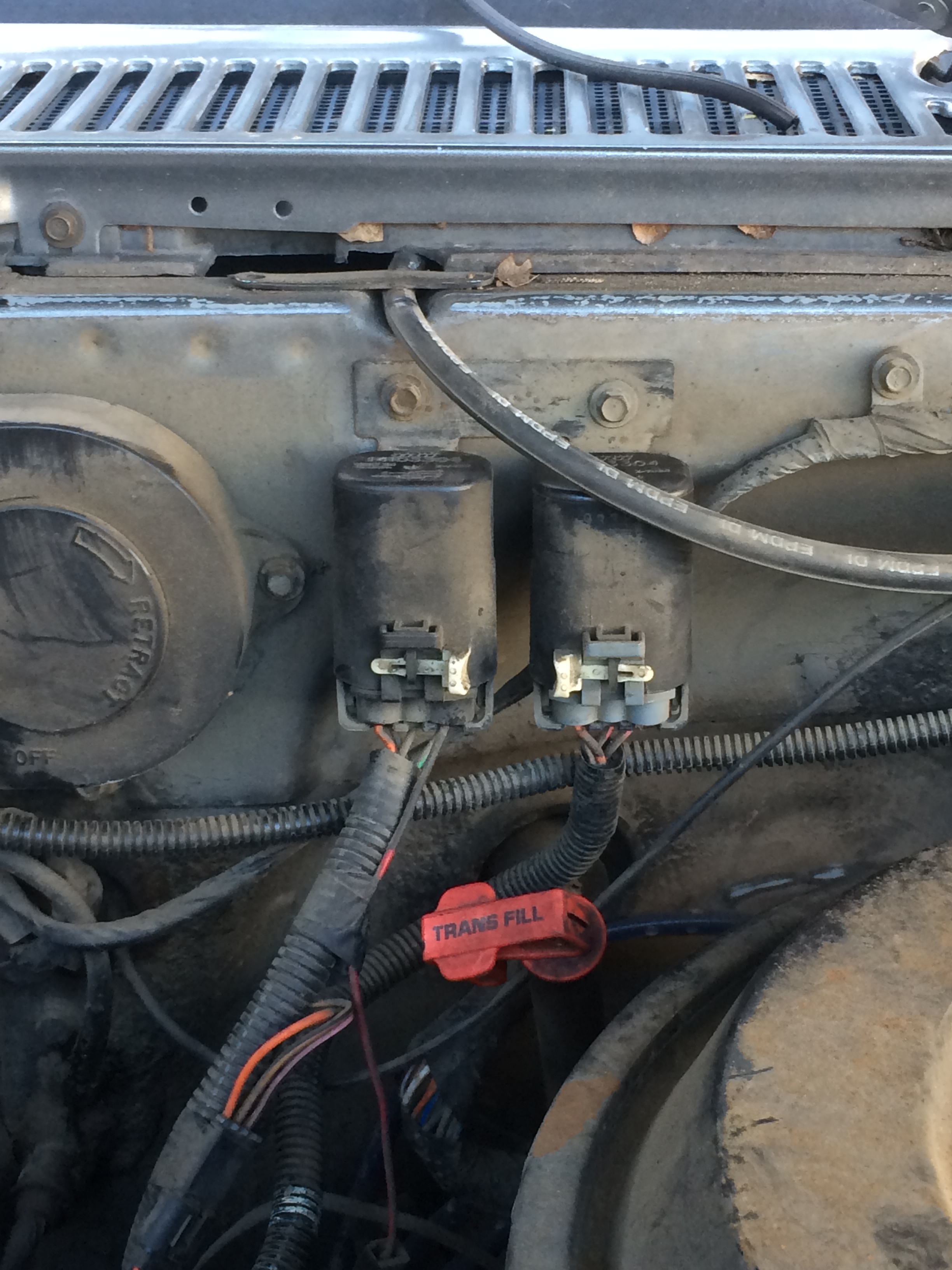

Im back at atempting to fix the intermitant wipers problem. The auto parts store only has the pulse module that attaches to the wiper motor list in thier books. I checked the firewall and found only two relays on the fire wall (see photos attached). Checked the manual and the switch it does have intermitant wipers. Could one or both relays be what i should replace?

I'd start by making sure the switch is not the issue, verify that if its off there is no power coming out of it...
Start at the motor and work your way back to see where the power should be off and its still on...
A relay could be stuck....
