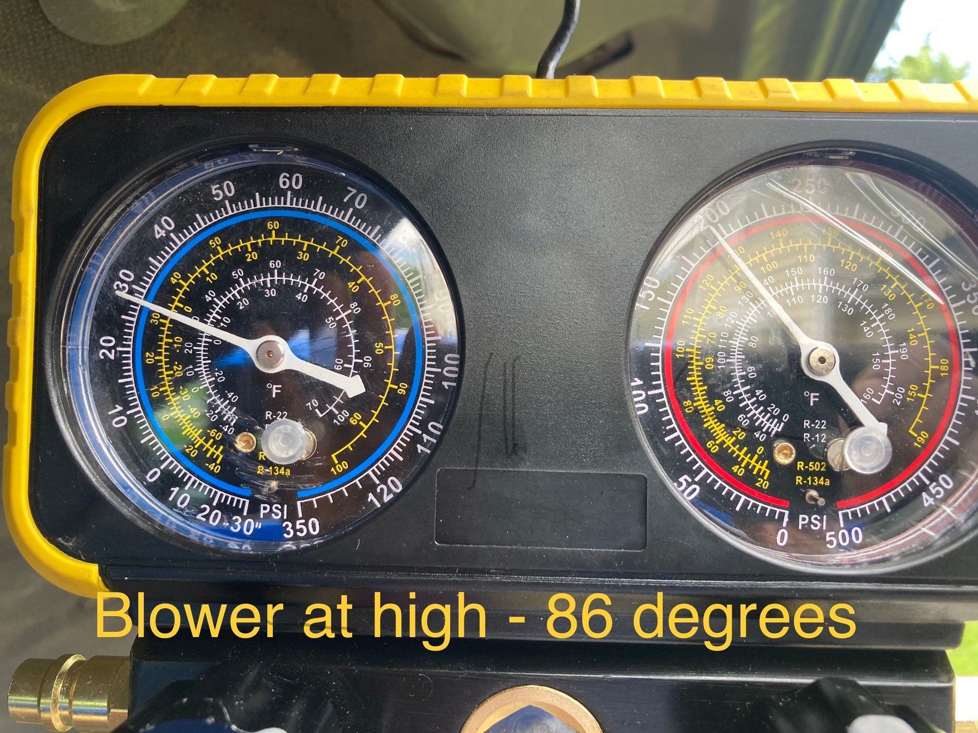

on my 2003 chevy suburban, I replaced the compressor, accumulator, and orifice tube. the A/C blows really cold air (measured to 40 degrees) when the blower speed is set to the lowest setting. The blower fan works at all speeds, as i have the "LED" bar graph to indicate when I increase or decrease the blower motor speed. the problem is when i increased the blower speed, (as measured via a thermometer) I noticed the temperature slowly rises. when i turn the blower speed down, the temperature in car again slowly drops down to the low 40 degree range.
what can i check to remedy this problem. the fact that the AC is really cold at a low setting indicate my AC compressor is ok?
I have included images of the low side of the ac, which does get very cold to touch on both sides of the LOW side connector. i took snapshots of my AC manifold tool gauges.

When you recharged the system did you put the 134 by weight ? That is the proper way. It may be slightly undercharged. Low side looks a little low at under 30 and at higher rpm it can cycle on the the low pressure cutoff.
