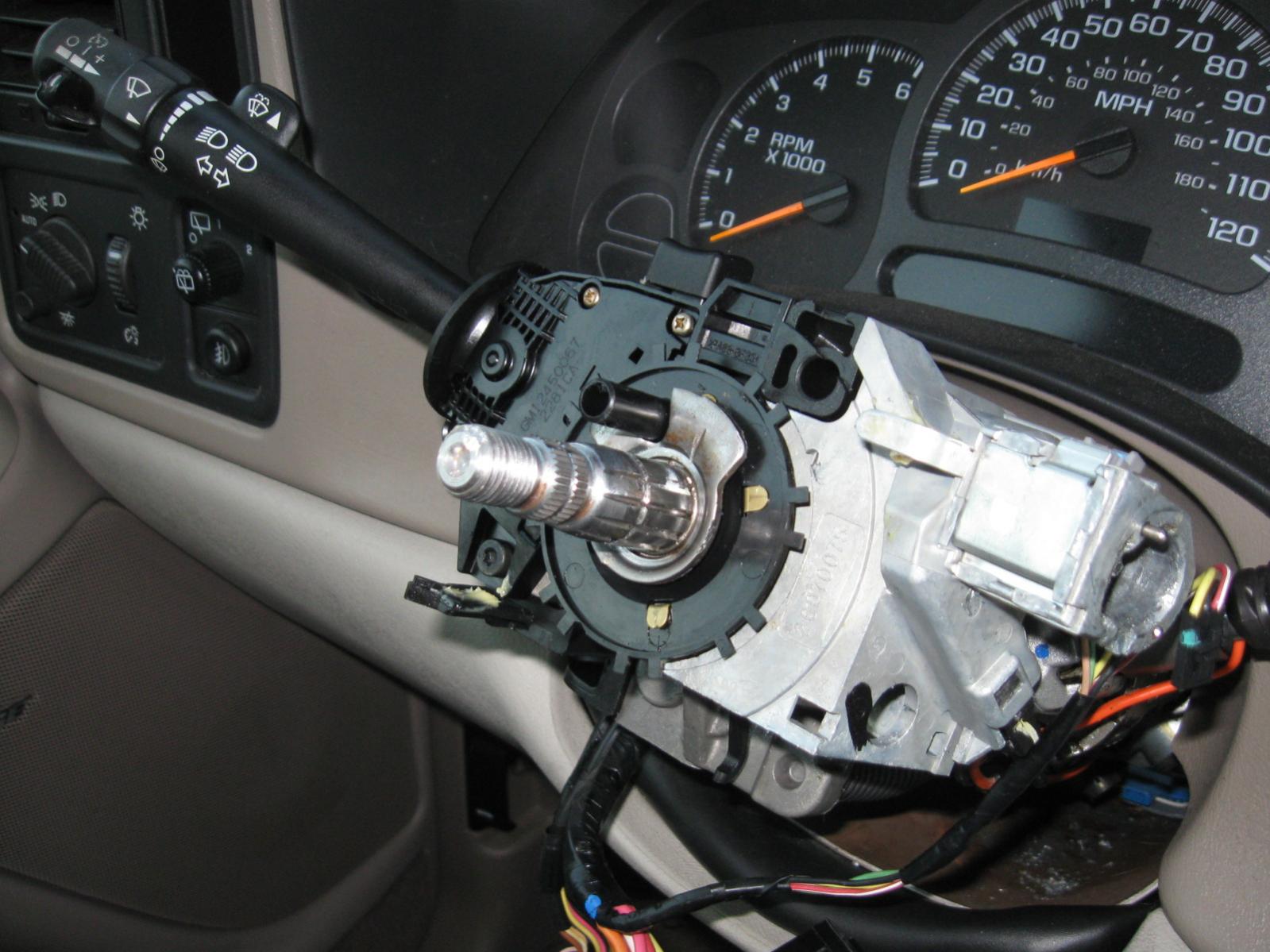

Well we finally got the pump swapped, onto the ignition. We ran into this after pulling the steering wheel off. The black plastic gear looking thing is blocking the torx screws needed to remove the housing and we can't figure out how to remove it.

You should only have to unscrew the 2 screws that are holding the turnsignal switch on and what looks like the one on the side.

I wish it was that easy.
I discovered that I am going to need a lock plate compressor to free up a little ring at the bottom of the shaft. Hopefully I can find one and get those damn screws exposed. Will any old parts store "universal" tool of that kind work, or are these year specific?
Also, I was told that I will need to dispose of said ring. Are they available at any parts store or will I have to order them through a dealer?
