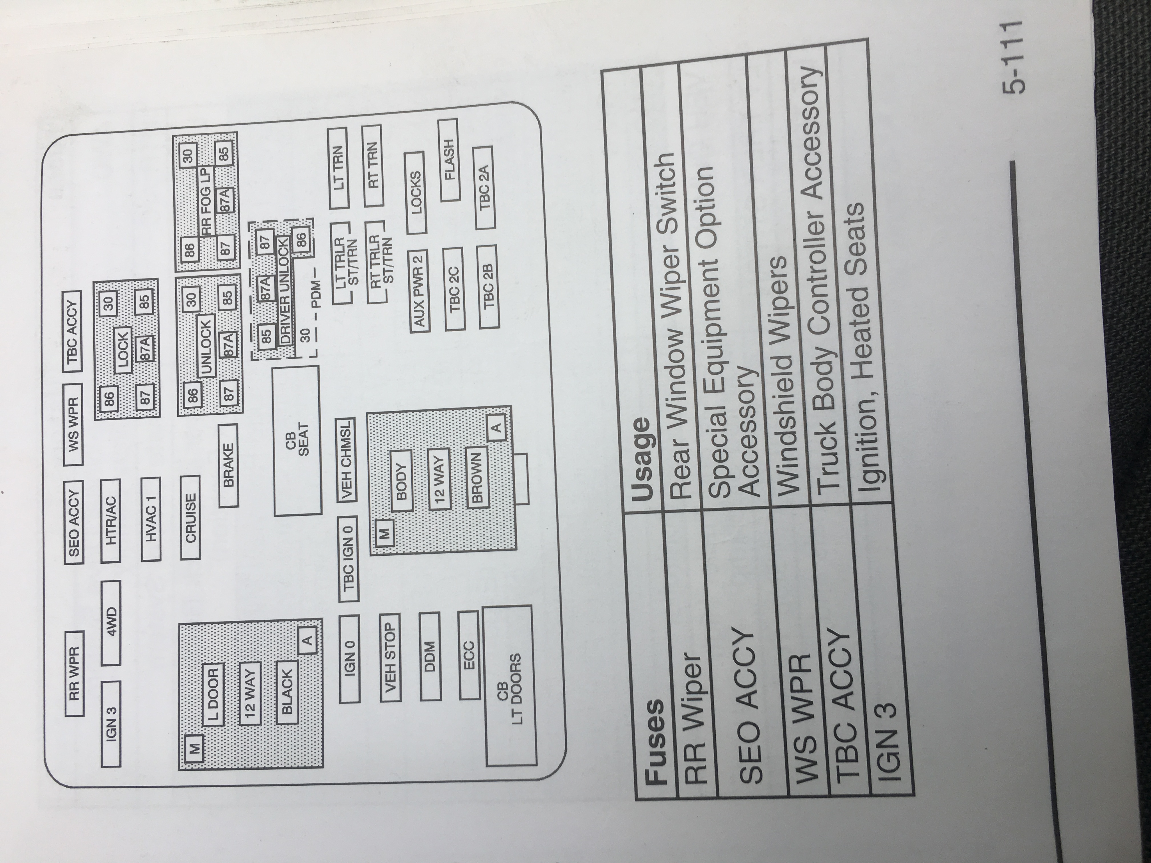

Old Apr 10, 2018 | 2:42 PM
Mmenzies@aol.com's Avatar
Joined: Mar 2018
Originally Posted by a55bruce
The Remote Control Door Lock Receiver (RCDLR) for the key fob is powered by the DSM fuse located in the instrument panel fuse block.
QA
Can’t find the DSM fuse in the instrument pane” fuse box
trying to post a pic
Old Apr 11, 2018 | 9:04 AM
a55bruce's Avatar
Joined: Feb 2012
Posts: 263
Likes: 22
From: West PA
Originally Posted by Mmenzies@aol.com
QA
Sorry for the bad advice, I was looking at the wrong schematic.
Are you following this procedure for programming the TPMS?
1. Apply parking brake. Turn ignition to ON position (engine off)
2. Turn headlight switch from “Off” to “On” four times within 3 seconds. A double horn chirp will sound and the TPM low tire warning light will begin to flash.
3. Starting at the LF tire increase/decrease pressure until horn sounds.
4. After horn sounds, proceed as in step 3 for the next 3 sensors in the following order : RF, RR LR.
5. After LR sensor has been learned, turn ignition to OFF position.
