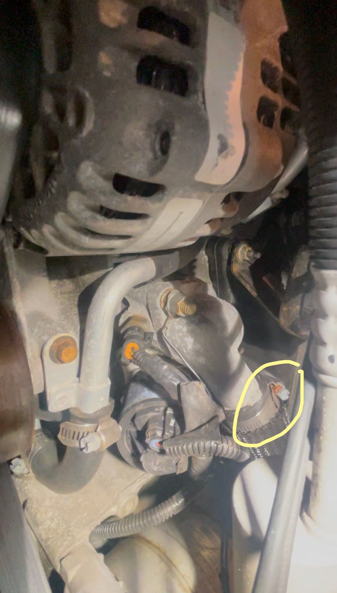

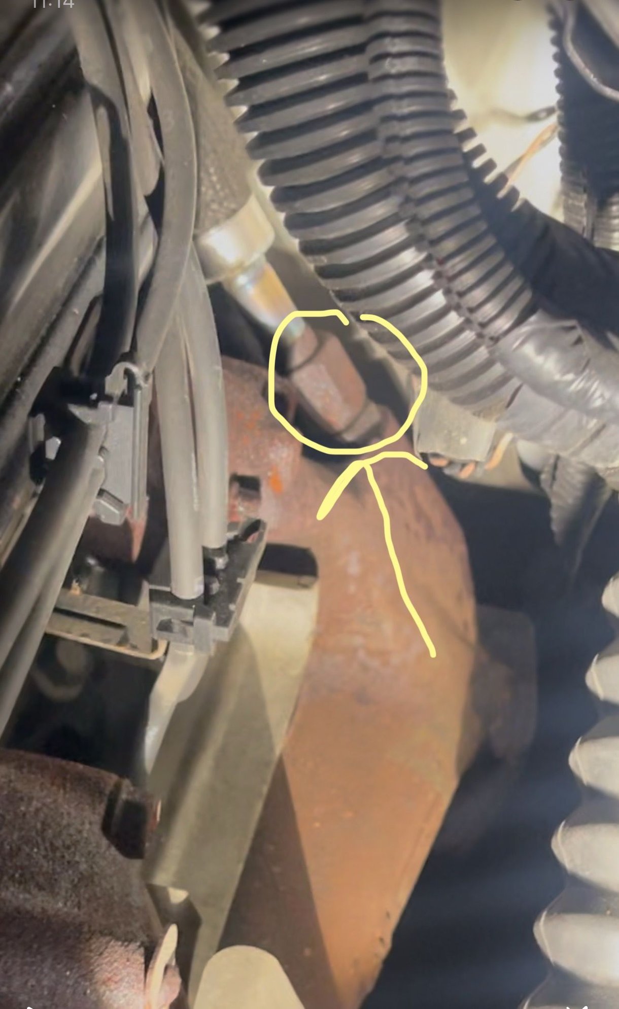

does anyone know what this hose adapter is for? its leaking oil. its on the driver side rear block and its above the oil housing.
It would be best to start a NEW discussion about your question, rather than jumping into a discussion that is from 17 years ago!
It could be the line for an auxiliary oil cooler. Or the transmission cooler. Trace the rubber hose and see where it goes.

it goes into a housing right next to the alternator
I am not 100% sure about what that hose is about.
As I mentioned before - this is a 17 year old conversation about leaking OIL PAN. Not your issue. You really should post this in the appropriate spot for your vehicle, so that we know the model, year, engine and other info, so that someone can help you. If you have a 97 Suburban, at least let us know what engine and model we are talking about.

yes its a 1997 suburban with a 5.7. im new here sorry
