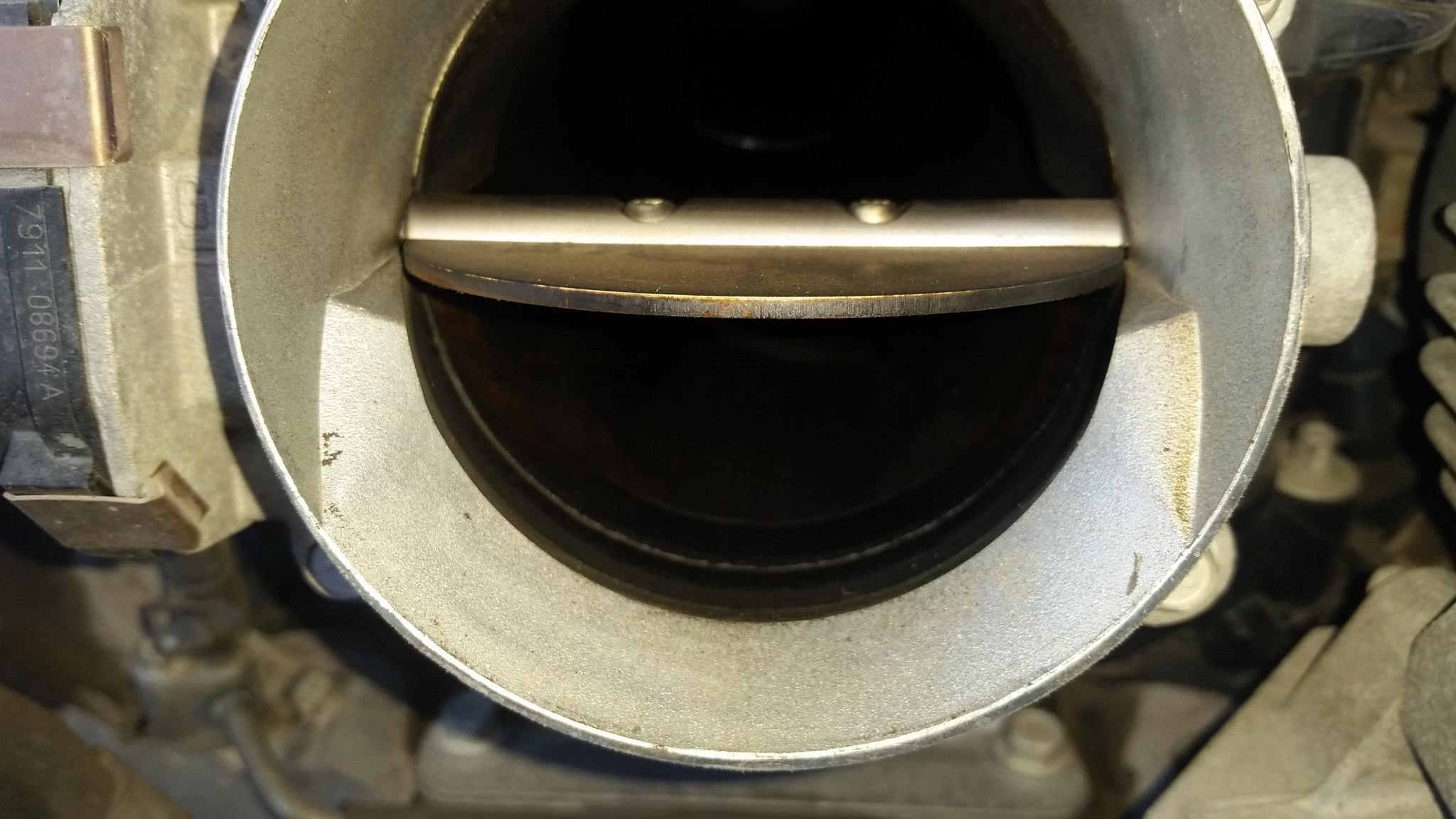

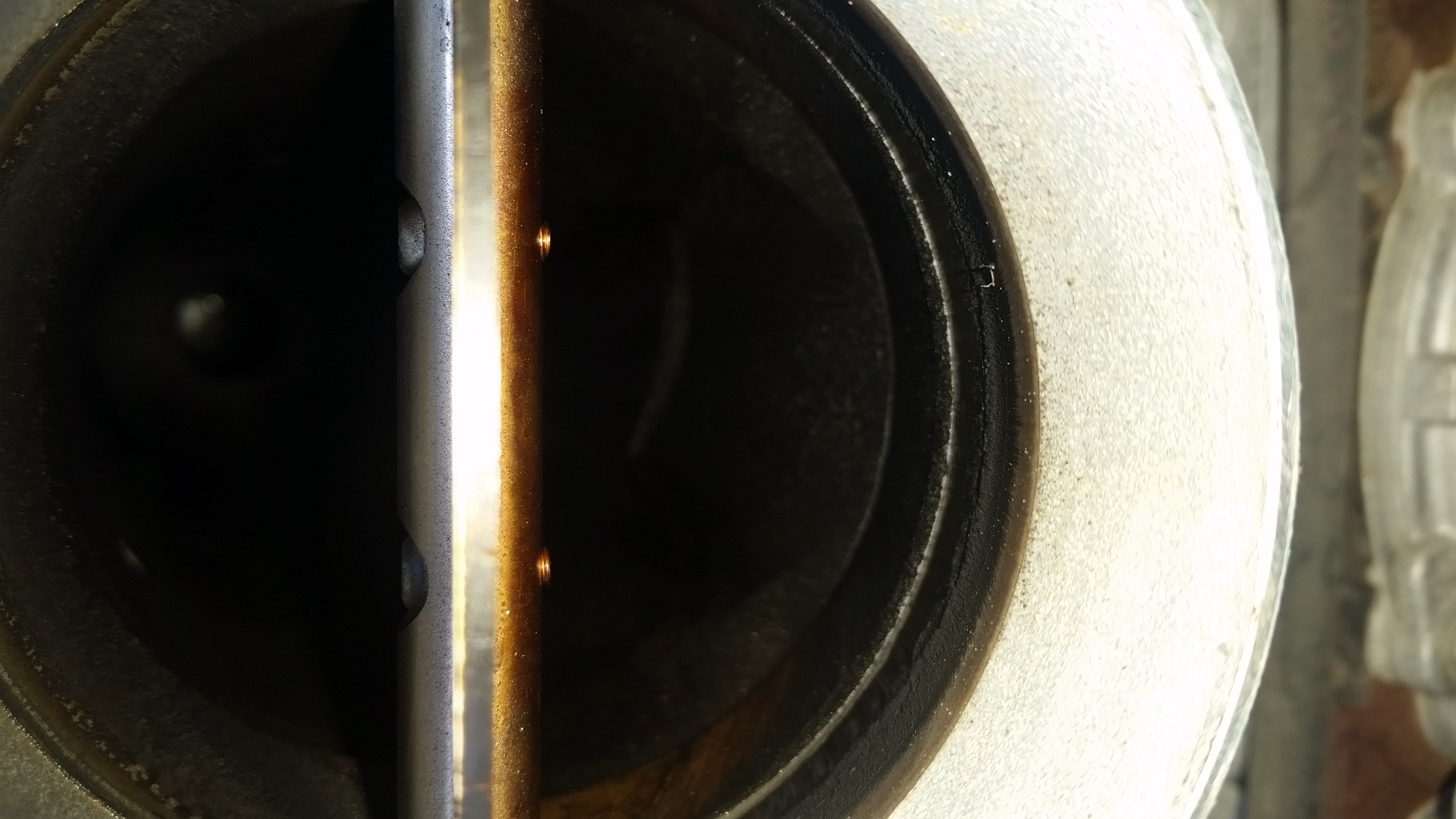

Took apart the air intake and behold, look at the pics, i might have the take the throttle body apart😢😢

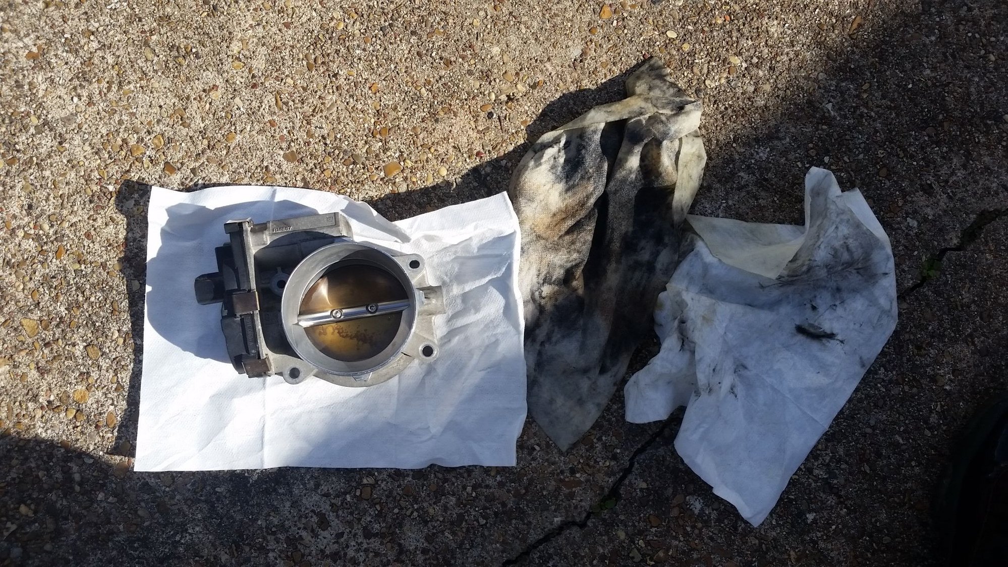

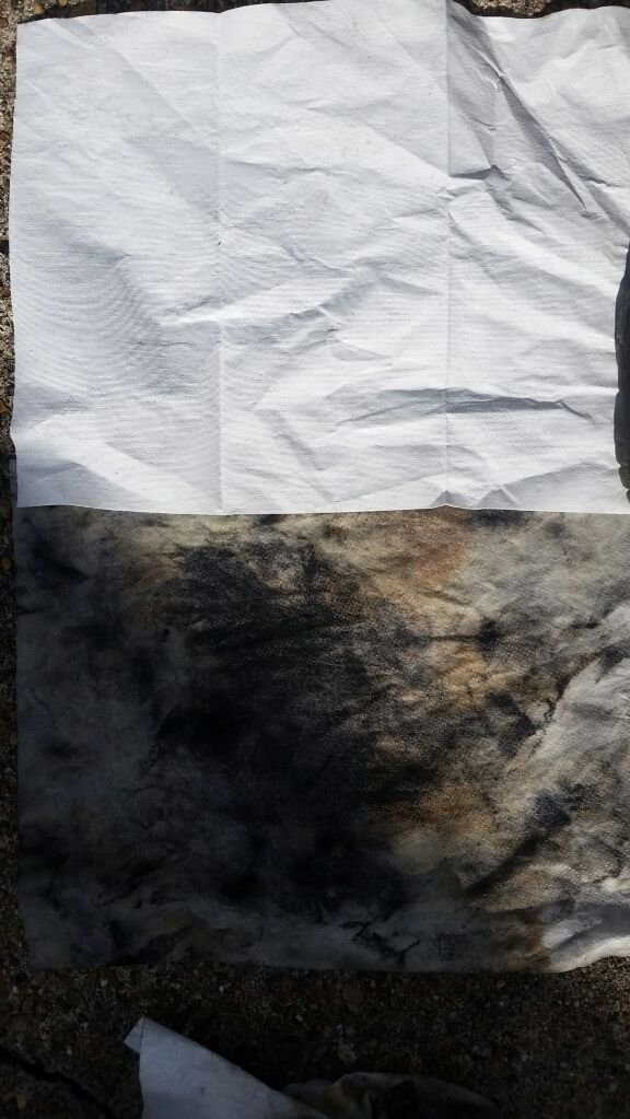

Difference in rags.. That black one was white

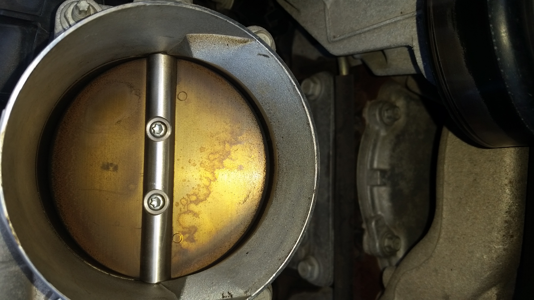

After pic
Much cleaner
