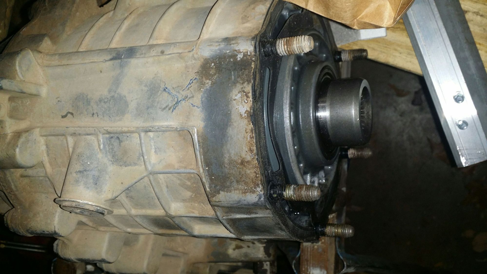

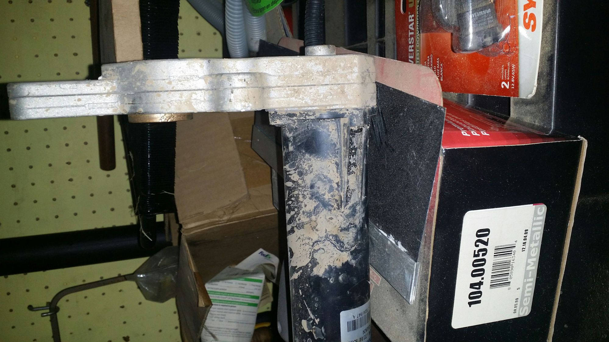

The (that) transfer case has clutch packs, and an electric shift motor. Always important to service everything. These images are a transfer case, shift motor (probably your issue), and clutch disk that was removed, and disgarded. Son's 2000 took a transfer case, replaced input bearing, drilled, screwed the clutch disk together so as to get rid of the shift motor. Engages the front differential when he needs 4wd.
