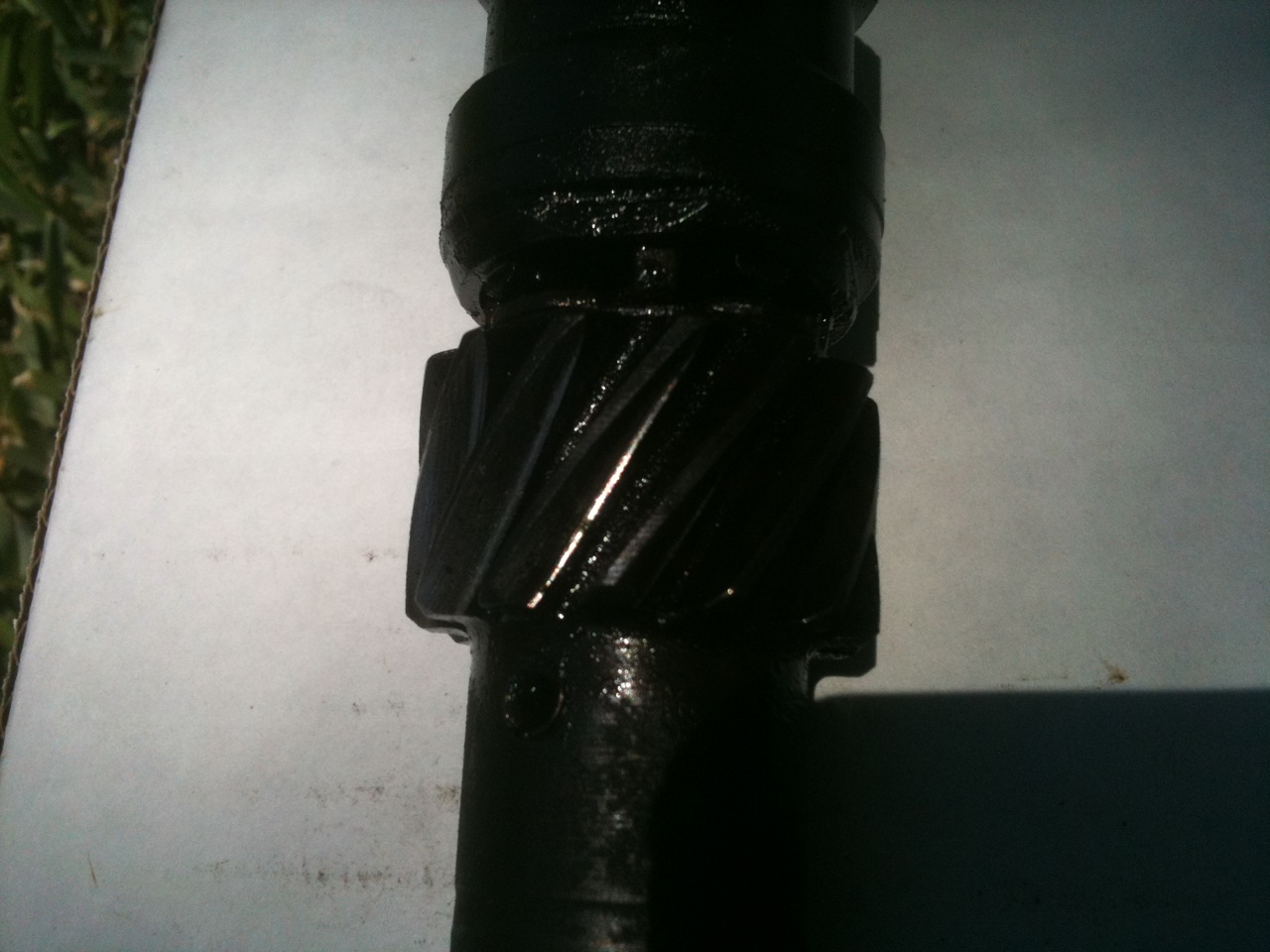

Ok, no luck so far. After double checking the plug wires, everything seems to be good. Wires are new, connected correctly, in the wire holders, and not laying on the block or exhaust manifolds. There are no visual signs of arcing or burnt wires.
Lariders mention of the distributor was interesting to me. I had heard this was common. With no mis-fires or trouble codes I was unsure, but since the subject kept coming up; I thought it would be good to check into. I pulled the distibutor and sure enough, it had excessive wear on the gear. I replaced it with a remanufactured unit, but I am still having the bucking. Thanks Lariders, regardless I eliminated a future problem. This gear was in pretty bad shape. I have attached a picture. It doesnt show very well but...
Thanks for everyones input so far. If you can think of anything else to check please let me know. I don't think that I am at risk of walking here, it is just very irritating considering the amount of money I have invested so far.

Old Jun 27, 2010 | 9:47 PM
LARIDERS's Avatar
Joined: Apr 2010
Posts: 294
From: Michigan
what all did you replace this time? did you get a whole new distributor?
