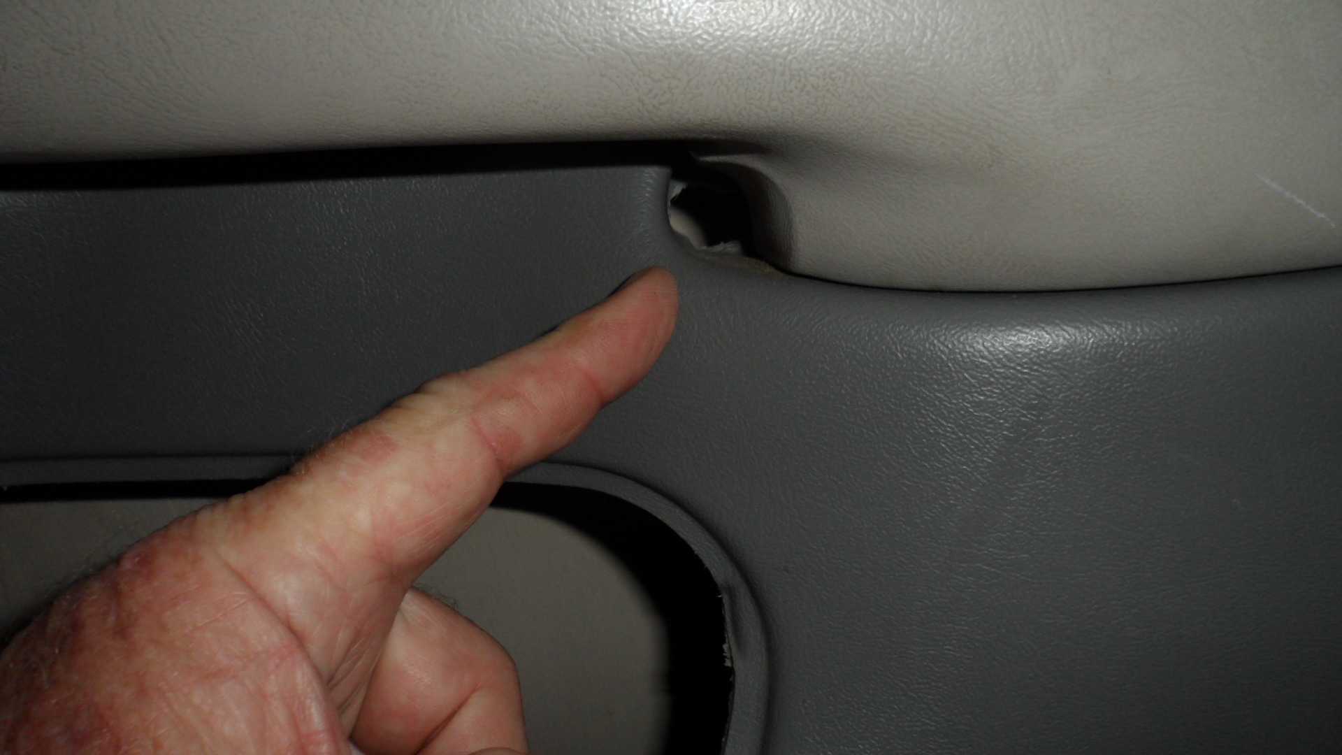

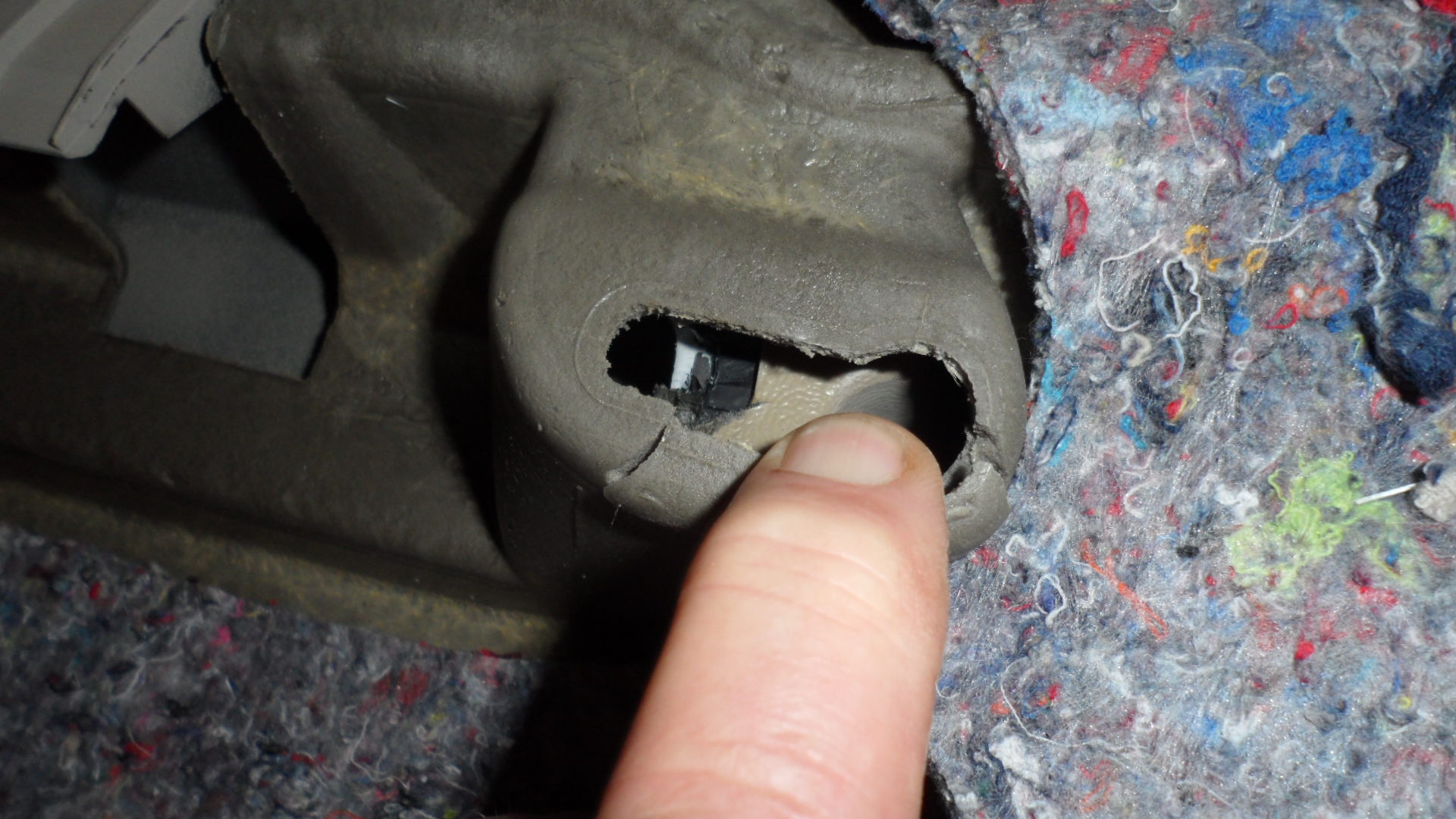

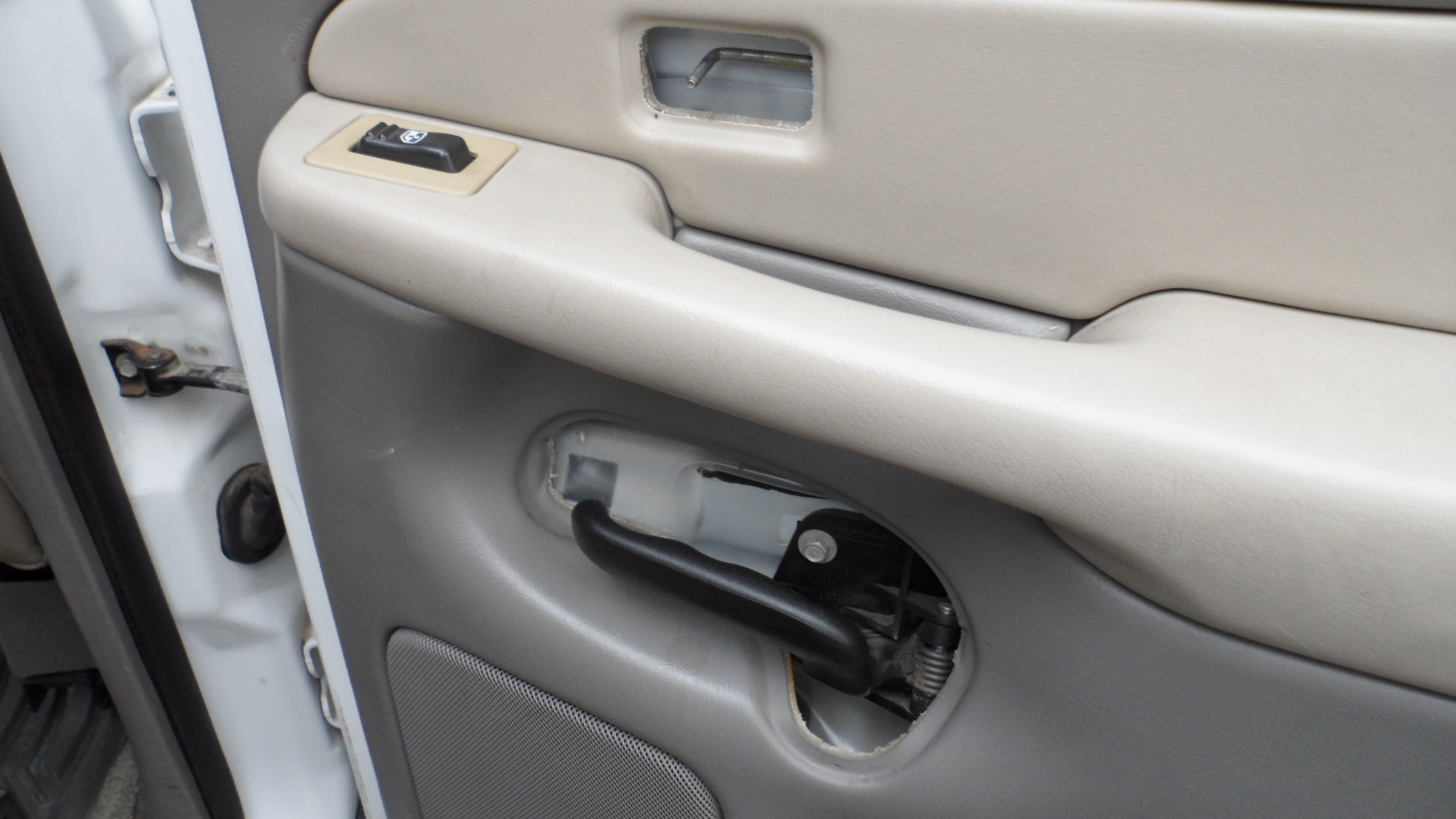

Removing door panel...Has TWO screws, not one. I removed the bottom and jerked upwards on the panel until the screw under the arm rest broke away. I'm waiting for JB Weld to cure before I replace the door panels. BTW they don't have push pins...there are about eight fasteners that release by lifting the panel.

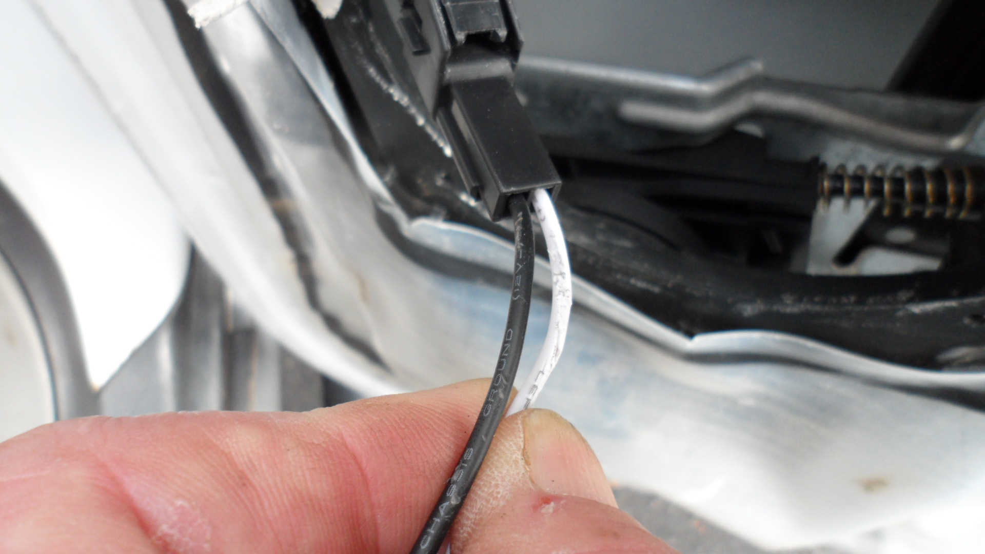

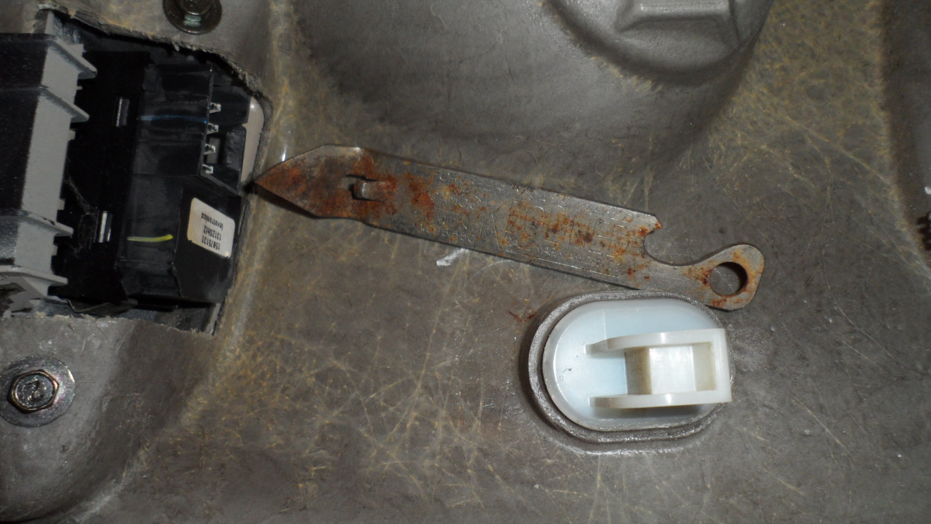

1. Pry out handle surround and the lock. 2. Screw hole under armrest. 3 Did not see second 7mm screw, jerked up hard and left a mess. 4. Before pop tops there were can openers. Works great to release window connector tab, especially on driver's side. 5. Tested windows when done and speaker connectors pulled loose, cut white insulation. Taped and cable tied to a nearby sheet metal hole.
Hints... remove two 7mm screws (not one as I did) . Cable tie adapter harness away from the window.
