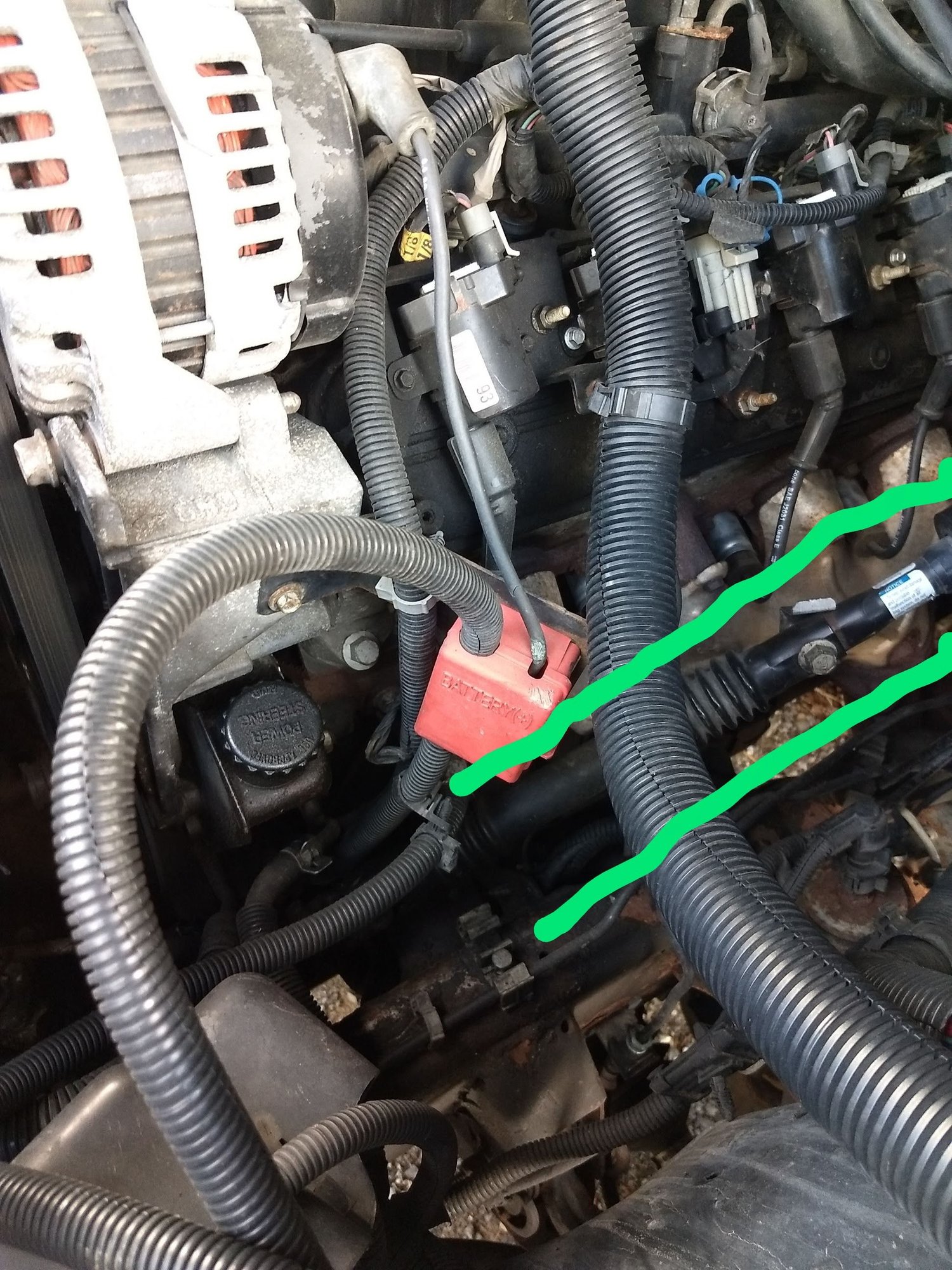

Yeah it could be your steering shaft, I'm pretty sure it's the upper shaft that gives the problems. Have you checked your ball joints cause they can make sound. I have a 2001 gmc yukon with 340000 miles, I'm just now replacing the tie rods and ball joints cause there is a good bit of play in my steering. Oh and to fix the steering shaft problem you un-bolt the upper from the lower and then you can push and pull the upper one. You pack grease at the part where the upper shaft slides in and out, i think it's under the boot. If you open your hood and stand at the drivers side tire and look down you should be able to see the steering shaft.
There is the best picture i could find of my steering shaft. You can see the bolt to take it apart.
