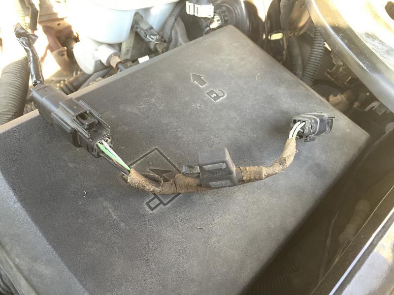

I have a question for you all that have had the windshield washer fluid heater recall done. This recall happened 5-6+ years ago and it was due to the faulty windshield washer fluid heater, which would somehow create a fire. I refused to have the fluid heater removed, I signed a waiver and was done with it. But I kept getting letters in the mail and the dealer kept reminding me about it and how it was still open in their system. Moving forward, I never had it removed, BUT years ago, they did apply the first "solution" to the issue, which was put an inline wiring harness which included a 5 amp fuse, unfortunately this fix still did not prevent the fires.
So I recently went to the dealer, if you may have read my thread about being there eight hours total. The service advisor "went ahead" and did the fluid heater recall, w/o asking me. I was "whatever" about it since I was about to spend 550 dollars on a upper control replacement, and I just wanted to get the heck out of there already, not to mention the bad alignment they gave and tried to talk me out of them re-doing the alignment.
So I googled the washer fluid heater recall, and saw that a company, Alphatherm, sells a replacement fluid heater unit, and folks were just buying these and it was easy install since our cars were built with these things and all the hardware and wiring and switch are already in place. So I went to check and see how the tech did the recall on my car, and I saw he bent the heck out of the bracket which holds the fluid heater, and then put the wiring harnesses on the wrong side of the bracket.
So now my question is, do I still use the "first fix" that GM put in place when I install the new fluid heater, which is the additional wiring harness with the inline fuse? or do I pull it out and not use it? I've uploaded a pic of said wiring harness.

I bought the Alphatherm unit for my Burb. They're only a few miles from my home, and when I went over there, I ended up talking to the owner.
I don't remember specifically, but I think I'd remember doing the install if it'd caused me any problems. I believe the wiring on mine was snipped at the plug, so I untaped and removed the old plug, and the new unit just plugged right in. I do recall that splicing into the washer hose was a PITA. I'd pinched the hose, so when I first tested it, nothing was coming out.
If you're going to get it, just buy it and figure it out once you have the unit in your hands. I don't have any such harness on my install.

it should not matter either way as the problem heater element is removed. leave the fused wiring harness in if you can. hope they left in the switch and heater mounting bracket

Thanks to all who responded. I am not sure of the gauge wire the new unit is, but here is a pic from alphatherms website.
http://www.alphathermusa.com/images/...sh-AT-37GM.JPG
I'm leaning towards not using the "first fix" wiring. I got word back from someone at alphatherm and he suggested not to use it, and said it would not make a difference at all. I'm not expert, only a novice, and I feel like the shortest path for the power would be best, but having another inline fuse wouldn't be so bad. I don't know... Darn my OCD!! lol!
