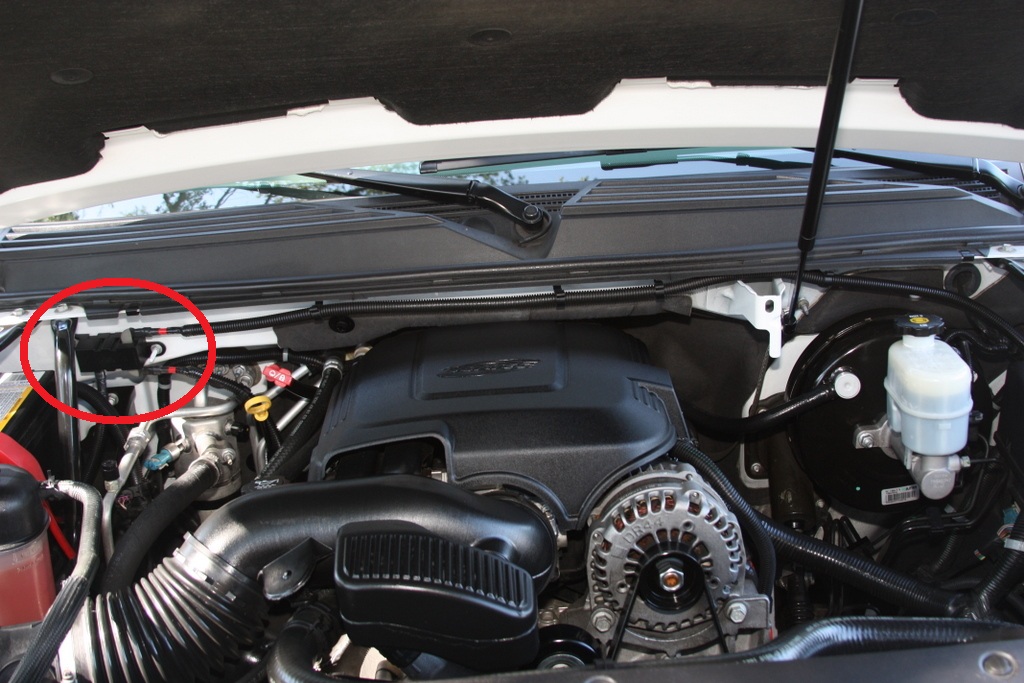

Have you checked all the fuses? Ignition fuse, the Mega-fuse located on the firewall near the battery?

Here is its location on my 07, the 03 is probably in a similar location...
-> https://chevroletforum.com/forum/att...e-img_0891-jpg

Yes, problem resolved...it was the Ignition Fuse by battery. Thanks for the follow up customer service, this is a great site and very helpful.
