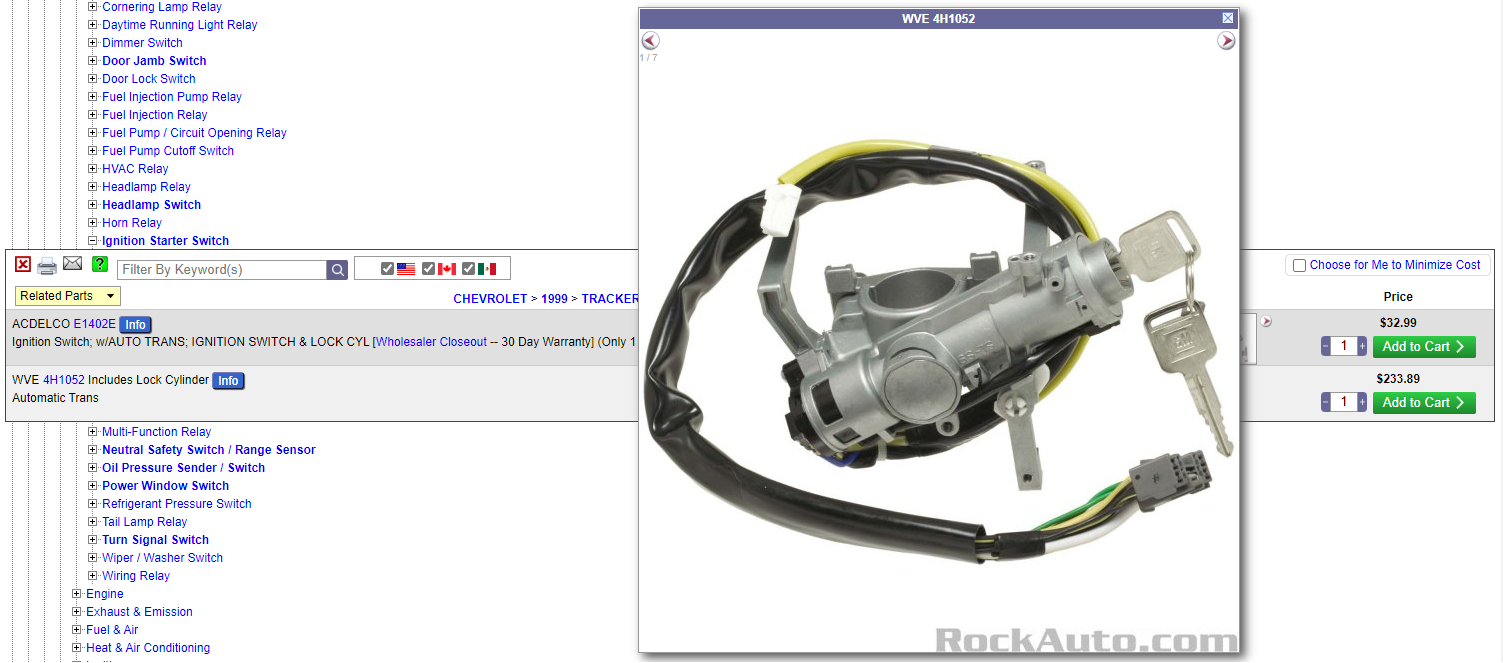

I have good news and bad news. The good news is this problem is easily fixed. The bad news it will cost you $250.
You can change the switch yourself (see YouTube videos online). Removing the two security screws will be a challenge but you will figure it out. The biggest problem with owning a 1999 Tracker is parts availabilty. Luckily this part is still available. Originally this car came with one key that fit the doors and the ignition. Having two keys means the ignition has been changed once already. Running a toggle switch is not really an option.
The ignition switch has too many wires to bypass to regain full operation of the vehicle. Order the switch while they still have one in stock.
