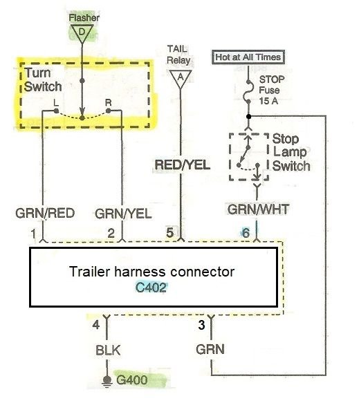

>>I have a 1998 tracker soft top 2 door.
I have a 2001 4-door Tracker. I don't know how similar the two cars are. I do know some vehicles did not come with a trailer pigtail from the factory.
On my car the factory connector is called C402. It was a little hard to find.
These are the pinouts for the 6-pin connector on my Tracker. If your wire colors are the same you might be able to splice in a connector.
