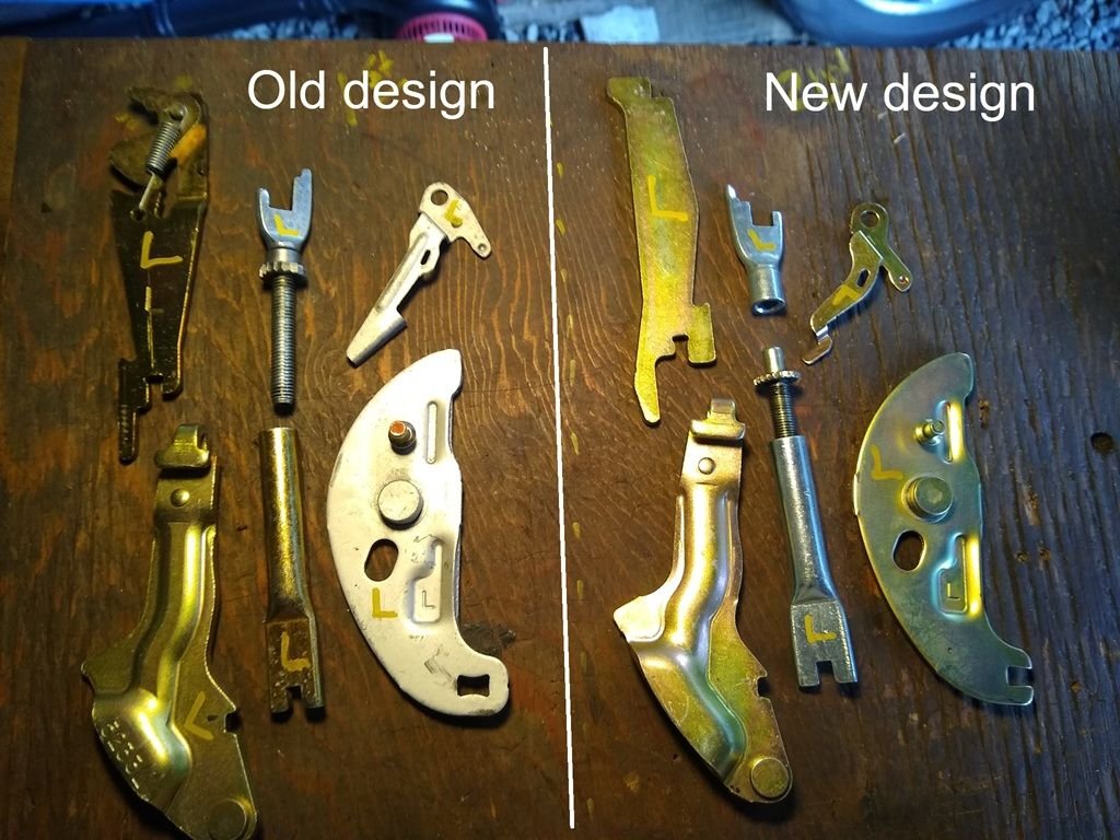

>> Parts geek canceled my orders
That's because 2000 and early 2001 Trackers use the "old" style brake hardware which is not available anymore. AutoZone will not have it either.

UPDATE: Shoes and springs are available but the brake adjustment hardware is no longer available.

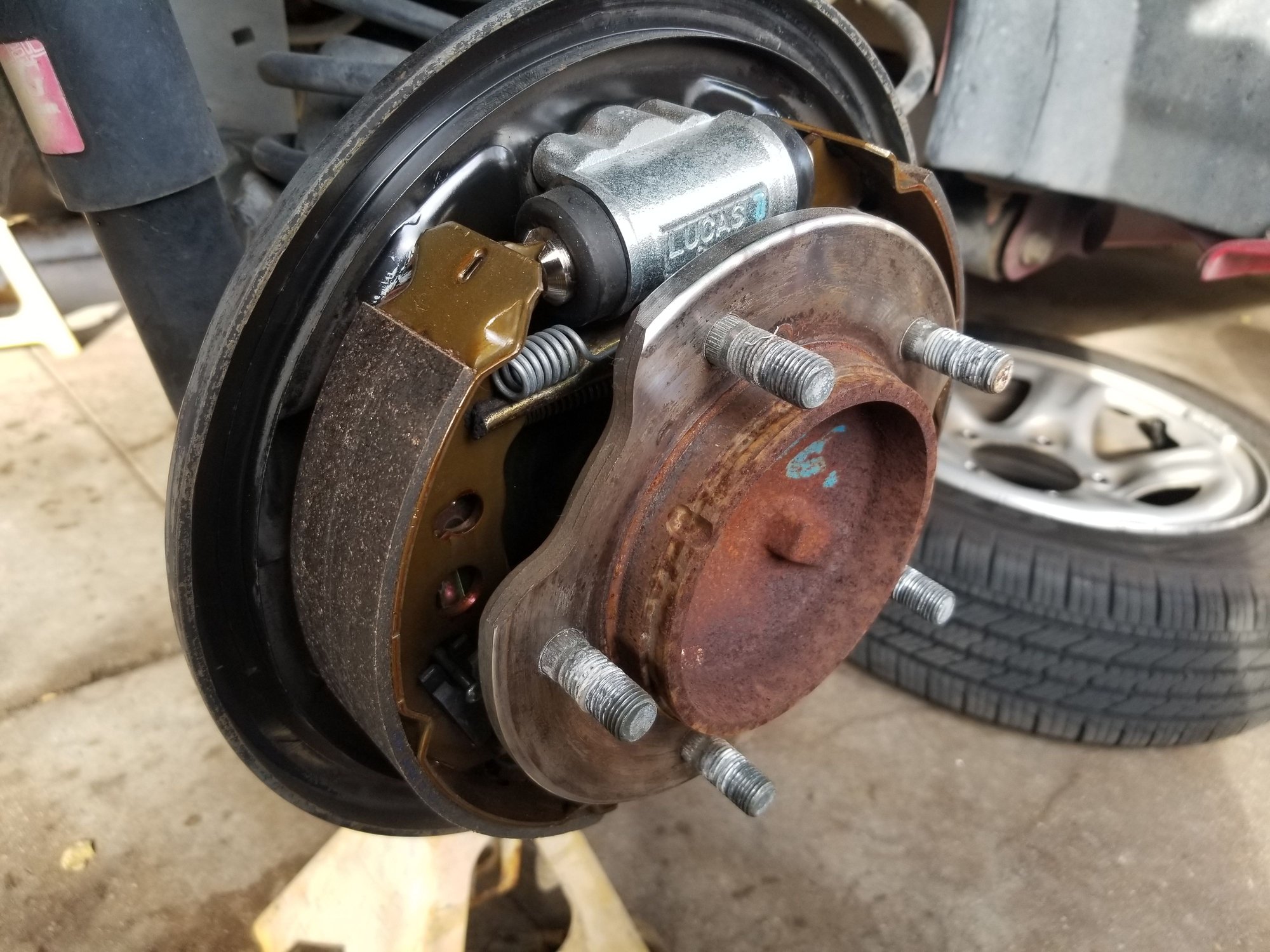

No ;
Parts Geek canceled my order because they claimed it couldn't be delivered .
This is the original brakes after a light cleaning, the leading shoe is paper thin, why I want to dip in and get them done BEFORE they go metal to metal and spoil my day .
This is how she looked when I 1st. removed the drum .
I have spare adjusters, the ones on the car now don't look bad, we'll see .

I think we have the same style brakes.
