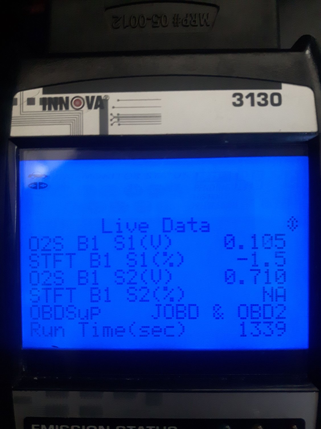

​​​​Hi I need help with interpreting the live data from my 2008 uplander. Previously i have an engine light and got a code P0172 with my OBD2 reader. It says fuel trim too rich on Bank 1.
I got a fuel system status: Closed loop, using O2 sensor for fuel mix.
I checked the MAF sensor and it was working fine.
I ohmed bank 1 and bank 2 Oxygen sensors and were both getting 5.7-6 ohms which is I think low but okay. I also checked voltage and were getting 10-12V.
What could be the issue? LTFT was -21% on idle and drop -15% on 2500RPM.

what does the live data for bank2 read?
is this a flex fuel compatible vehicle?

It does not show any B2 live data. Yes it is a flex fuel.
Old Apr 10, 2018 | 11:40 PM
  #37
check out the flex fuel sensor reading. If the sensor is reading more than 10% and you don't use flex fuel, reset the flex fuel sensor. if its askew, the fuel trim will run rich.

Hi Tech2,
My OBD scan tool dont have the capability to check fuel content and I am in search of shops that has GM tech2 scan tool but no luck.
I started my van this morning had some hesitation starting but it did start. On idle my van seems like it was shaking not like a usual idle where the engine is quiet and run smooth.
Two months ago I added kleen-flo premium gas line antifreeze because I left the van stored in my garage (with full tank) and we live in a cold environment which we had -20 degrees celsius 2 months ago. I was hoping it will prevent moisture build up in the gas tank. Now I was thinking that started the problem.
