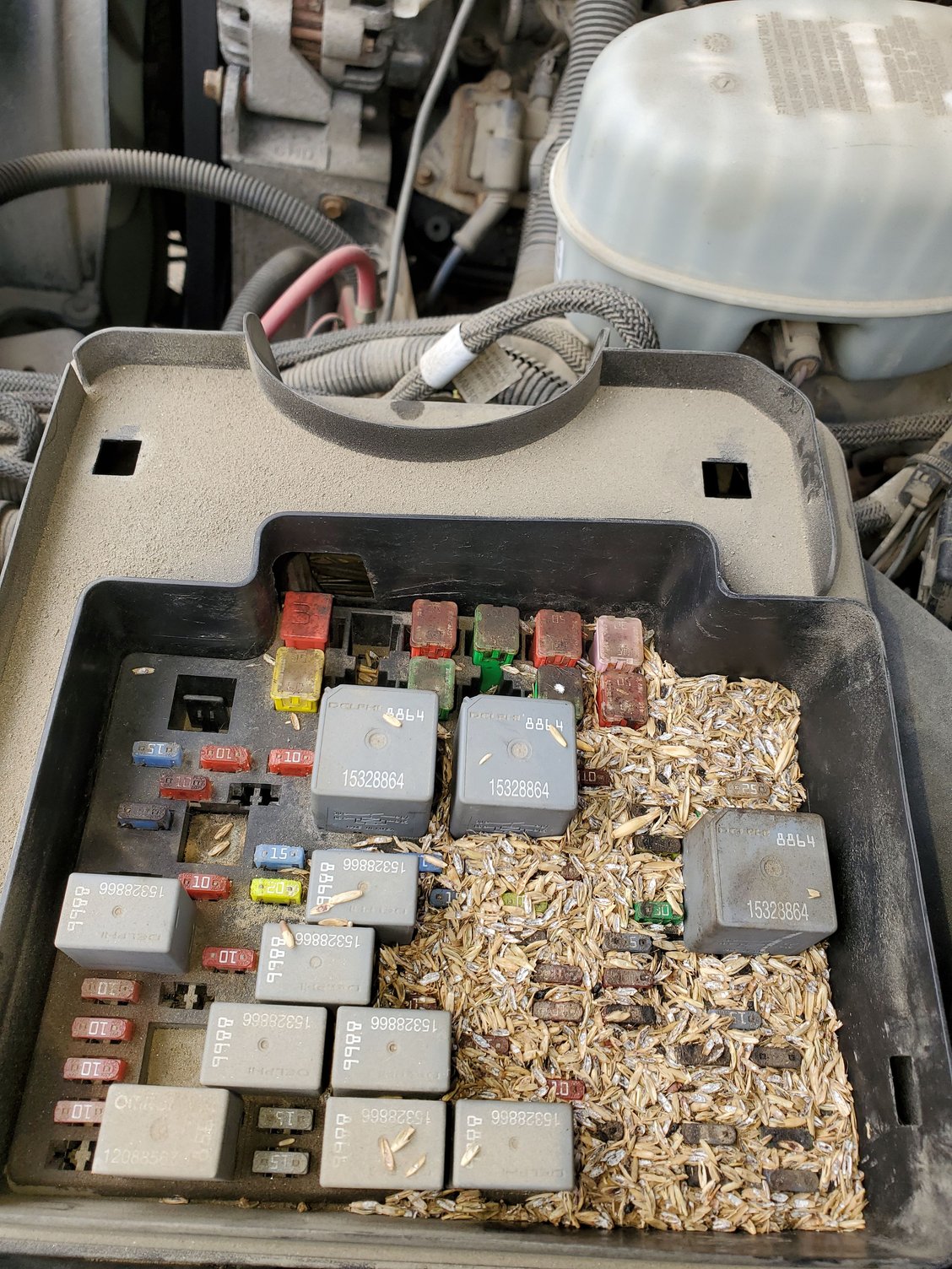

Put in new battery (tested bad), new alternator (tested bad), new headlight switch (tested bad), new low beam relay switch (tested bad).
After replacing the above, the truck would minimally run... after much hesitation I got deeper into the engine compartment fuse panel. Doggone mice had made a mess of the panel. Corrosion was found when pulling out individual guides and relays. I don't have the expertise to remove and install a used upper panel, so is simply removed each guide one at a time / sprayed CRC Electronic cleaner inside the female connectors, let sit and put new fuse in. Worked my way through this procedure until all fuses were replaced. Lifted the upper panel up and sprayed the underside with the electronic cleaner and let it air out. Found 3 wires that needed splicing due mice nawing on them (soldered and shrink wrapped them)!
The trick stayed right up! Let it idle for 20 minutes so the ecm and other modules could go through idle relearn. Then drove it on road (using the basic relearn techniques posted on this forum).
Keep in mind, my obd2 was telling me all kinds of wild expensive things! It taught me to go back to basics! Alternator, battery and other bench tests for switches, relays and shorts. $300 vs $2,000!!
I need to replace the upper fuse panel, if I can find a decent used one. That is going to be an interesting experience when I do replace it.
Anyone with an idea (besides eBay) to find a fuse block?
Thanks for all of the great posted info here!
Body and frame are solid, engine (6.0) is new with only 15K on it). Needs cab corners and rocker panels... think I'll go slip on because i have zero welding experience. Thoughts?
Mice **** under the hay seeds the mice were kind enough to leave!
When you zoom in, you'll see the black wire almost chewed through, but the yellow and grey wires that are twisted around each other just above the black wire - well i don't know what they go to, (any ideas???), but they were shorting out against each other due to bare spots! And yes that's one of 4 dead mice i found.

I’m not sure exactly what the yellow/gray wires run to, but any wires that are twisted together like that are referred to as a “twisted pair” and they are coming from one of the speed sensors. It could be one of the ABS wheel speed sensors, or one of the speed sensors for the transmission or transfer case. The reason they’re twisted together is to help shield the signal from interference from other circuits. When you repair them, try to keep the length as close to original as possible.
