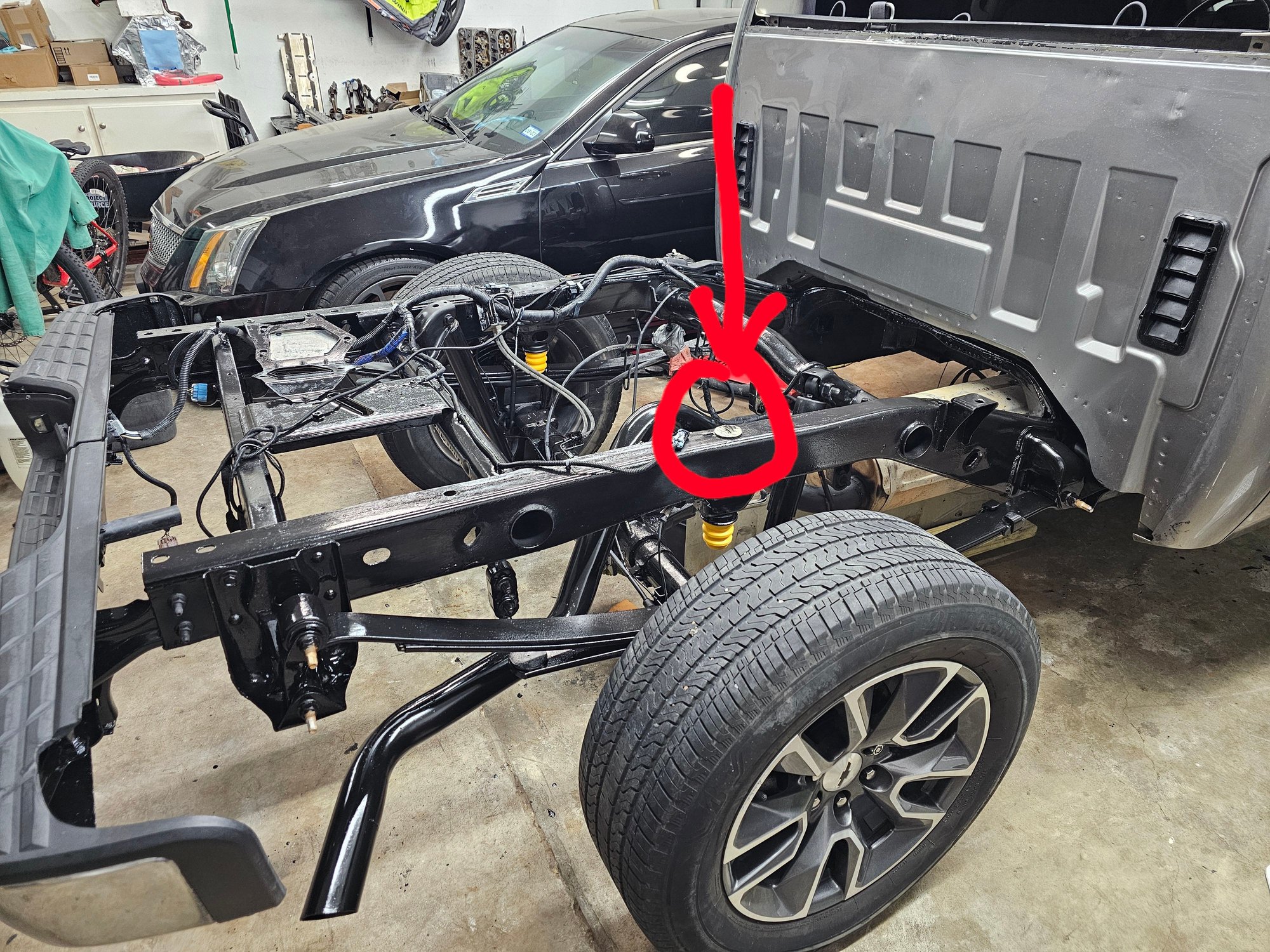

This is just a close up picture of the little plastic spacer
This is some sort of plastic shim to keep the bed and the frame from rubbing. The truck is a 09 Silverado 1500. I just painted the frame but mispalced the other shim.

Google “truck bed mounting pad” for all kinds of replacements.
You probably won’t find an exact match - if the pads you get are thicker or thinner than the existing ones, replace them all with new.

so what i did was just took measurements and printed one off of my printer out of tpu, if you need the file i can send it to you just let me know
