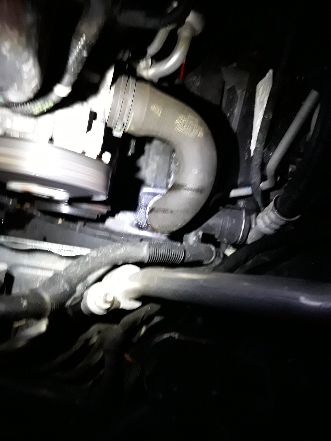

One morning I saw coolant under my vehicle but didn't have to check it out and didn't think it belonged to my car. I noticed the heater wasn't working properly and the engine heated up very faster than normal even though it was around freezing ambient. I looked in the bay and found leaks around this metal attachment to the hose [see pics in attachment].

In the 2nd photo, the hose that is circled is A/C line that carries freon (not coolant). The "wetness" around the crimp is the oil weeping out that is used to lubricate the AC system. So in addition to the coolant leak, there is a freon leak. For the coolant leak check all hose connections. Leaks usually but not always leave a tell-tale stain. Also check the water pump weep hole. If there are stains or wetness there the seal is going and the pump needs replacement. Has the coolant level been checked?

It was a red color leak, is the freon lubricant red? Maybe the coolant was leaking onto the a/c line [I thought the a/c lubricant was embedded into the freon]...? Maybe somewhere around the radiator was leaking?

Not sure what color the coolant should be and I don't think the oil in the freon has a color. I've owned MoPar's for the past 30 years which use a different coolant (Zerex G05 - it's a peach color) and just recently purchased a 2014 Equinox as a replacement for our Journey that my wife totaled after spinning on black ice. It could be coolant that somehow got on the AC hose. If you don't have heat after topping off the coolant I would suspect a blend door issue or maybe a clogged or partially clogged heater core. It's possible a flush will alleviate the clog.

The only color used in an A/C system is green, if any. You can add it to your A/;C system, but I am guessing thats orange 5 year coolant on that hose.I'd hose it off with brake cleaner to get any oil off then hose it down with water. Let it dry, then, warm up vehicle to see exactly where this leak is. Everything else is speculation right now.

It happened again. Believe it or not it hasn't happened before now since that last time 2 months ago. Now, the only pattern I can see is; It's brought up to operating temperature, then left to cool off when it's cold to frigid (low 30-20's or lower). It's definitely coming from the back right side of the engine......
........It was just the belt spinning it and making it land on the AC line

Had the same leak and it was this hose on the bottom. It was spaying onto the belt and going all over. It was the cheapest part I have ever bought from chevy $35 and the easiest to replace. The weep hole is on the top of the water pump so you would have been able to see it.
