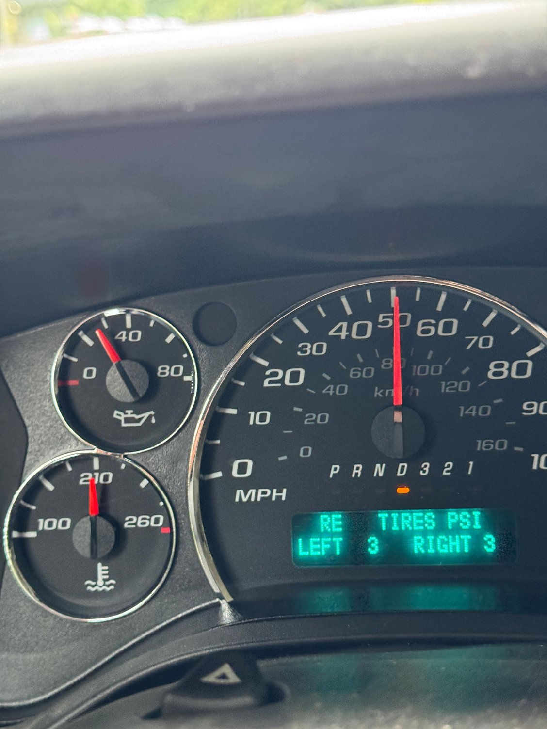

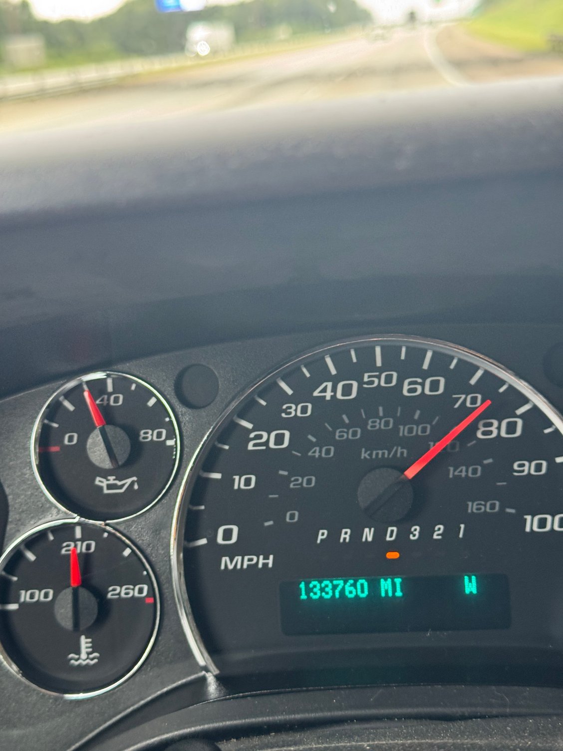

So the oil pressure was not really low, but a little lower than usual. Below are the pictures of the oil pressure. It usually is on 40. What do you think.

what is it at idle? have you ever set the oil pressure alarm off?
Honestly, I’d get another opinion from a different shop. That one seems a little too eager to jump on a camshaft sensor code. If the engine was knocking or showing signs of something serious, maybe a bigger repair would make sense. But if all you’ve got is a camshaft code, I wouldn’t even think about replacing the engine.

The first picture shows the car at 70 mph and the second at 50 mph. The engine does not show any signs that something is wrong. After the oil change, the pressure is also back to normal. at 40. No alarm went off, ever. I was thinking about getting a manual oil pressure check done.
