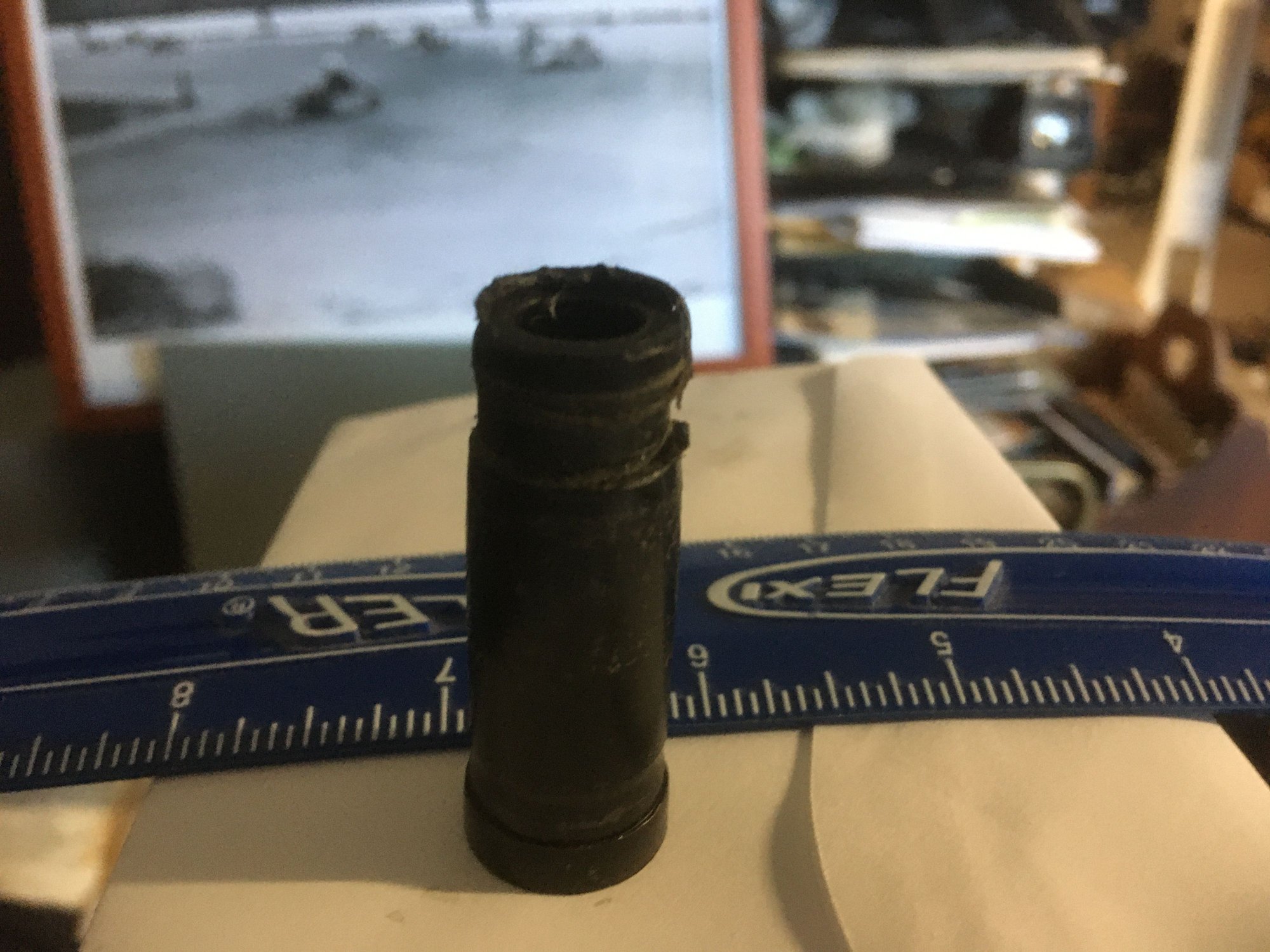

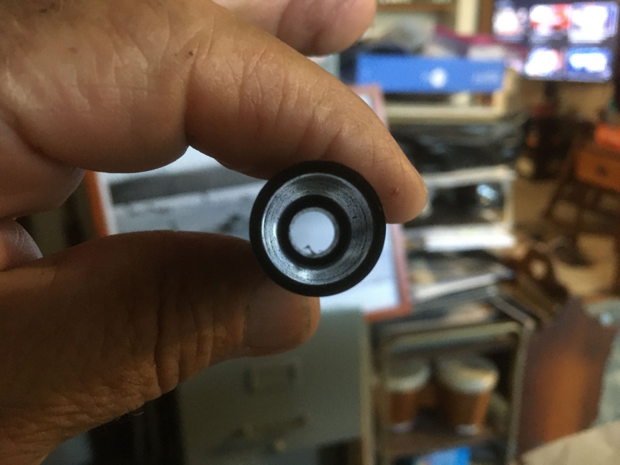

This is the hollow plastic part that had not failed yet but nearly as you can see.
It is about 5/8 od 3/8 id black delrin type plastic. If I could have figured how to get the box out I sure would have then I could have changed to a bolt like the brake pedal has.

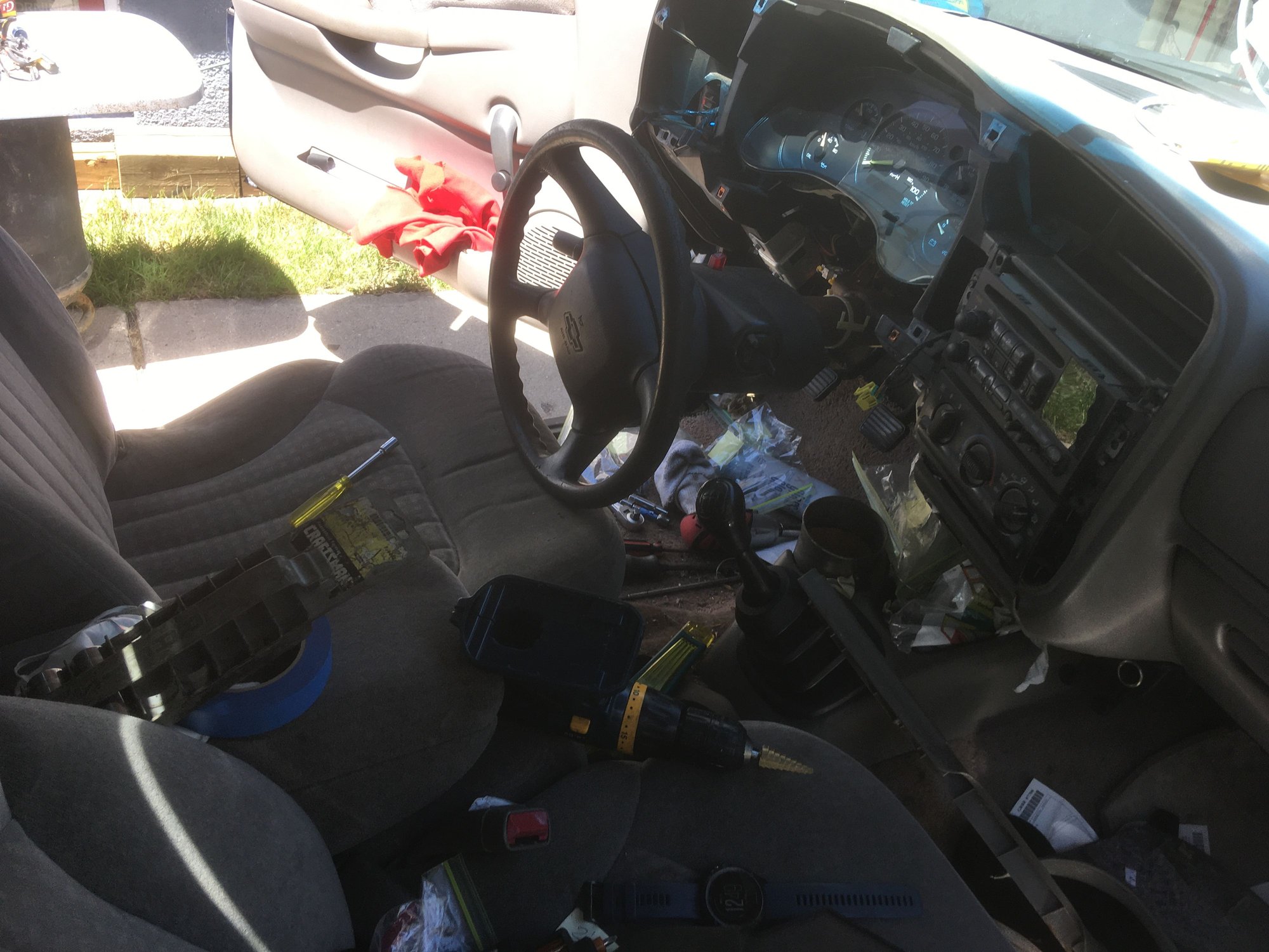

Same problem I guess. The little black things that pop out broke as my clutch went out on me. I replaced clutch then noticed pedal broken. Went as far as removing fender making a hole to access the backside of where pedal attaches and ran a bolt straight across to act as a hinge. Then truck acted as if clutch needed bled once I started it. I'd start in neutral and wouldn't allow me to go into gear then if started in gear it would pull as I was starting it and Stahl itself out once I applied brake. So then I replaced the master slave cylinder ( whatever the part that goes through firewall to clutch pedal) I replaced that and still same. So now I've been told the little play I have in the clutch pedal from where it slightly wiggles on the bolt (hinge) is enough to keep it from operating enough to properly bleed. So went to junk yard found an S10 identical to mine, also a 99 and when I looked under dash was surprised that it also being a 99 has a factory bolt ran through where the black plastic and springs broke in ours. So tomorrow I'm taking dash out and replacing the entire brake clutch cast iron housing.i guess and seeing what happens then. Any helpful suggestions would be appreciated
