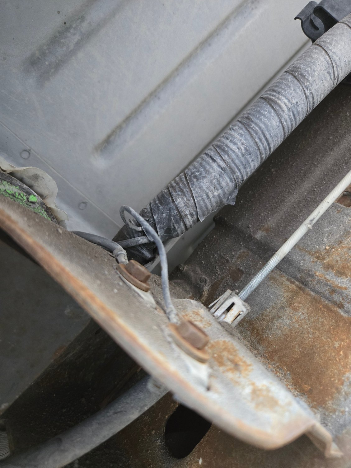

I have a 2005 Denali and the drivers side heated seat switch has a mind of its own also. After wet weather, it will come on by itself and the heat levels will just start going up and down on their own. It looks like the control lights are dancing.
In my case, I had a bad ground. Under the body just behind the drivers side front wheel, there are two ground wire connections bolted to the body. I removed the bolts, cleaned the contact surfaces and reconnected. No more dancing lights on the heated seat control.
Clean the contact surfaces on these ground connections.
