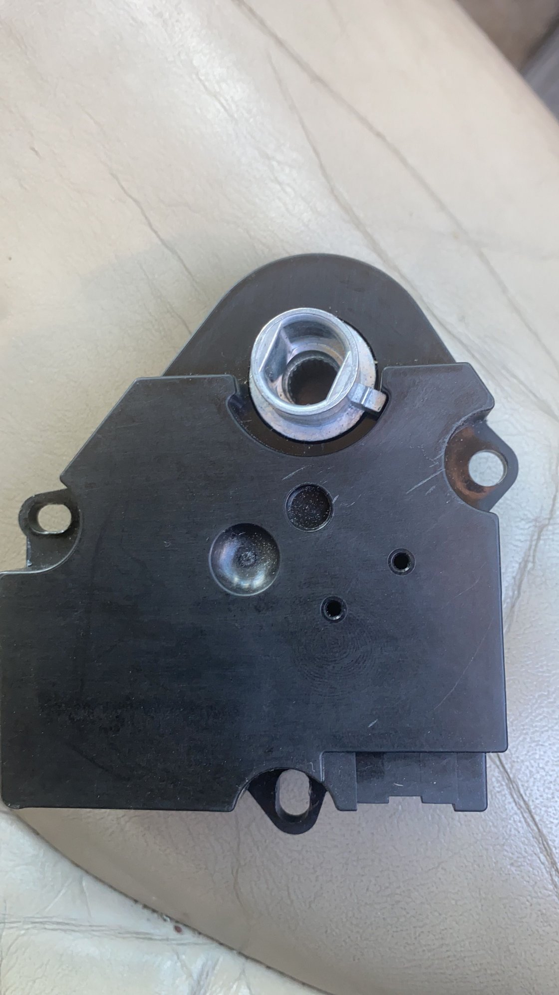

At first I noticed that the blender motor was not moving anymore. Got a new one. I then realized that I am getting hot air no matter what position the blend door is in.
what could be causing this? I am pretty sure that the blend door is still there, as it takes a little bit of finger force to move it. Besides; where would it go?
is it correct that it should only move about 40 degrees?

Originally Posted by Cusser
I had to replace a blend door actuator on both my 1994 Suburban and 2005 Yukon.
Maybe temporarily move into the "cold" position and leave the harness/actuator uninstalled.
I think the repair will be $300-$400 at a shop.
yeah I have done that. I now realized that I am getting hot air in both positions! The door does not seem to be able to move as far as the blend motor is supposed to. It wilø only move about 30-4 degrees rotation. While the actuator has a range of about 160 degrees.
Guess I will have to take the whole thing apart now…
