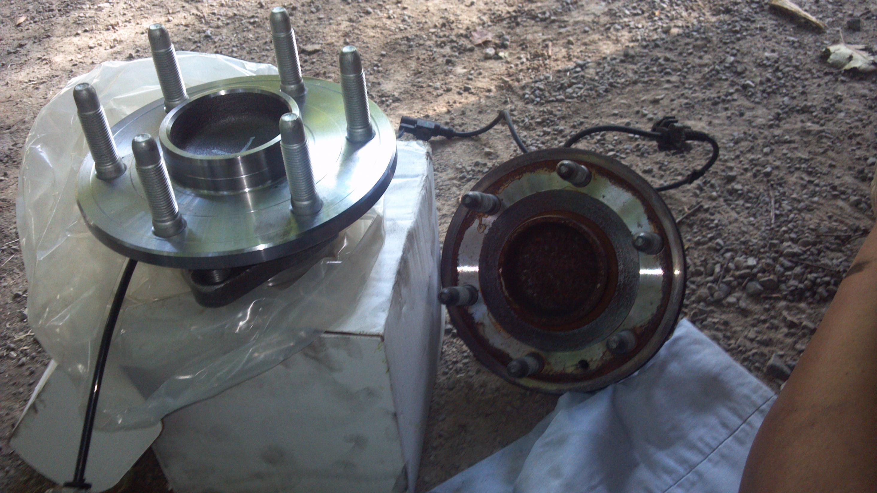

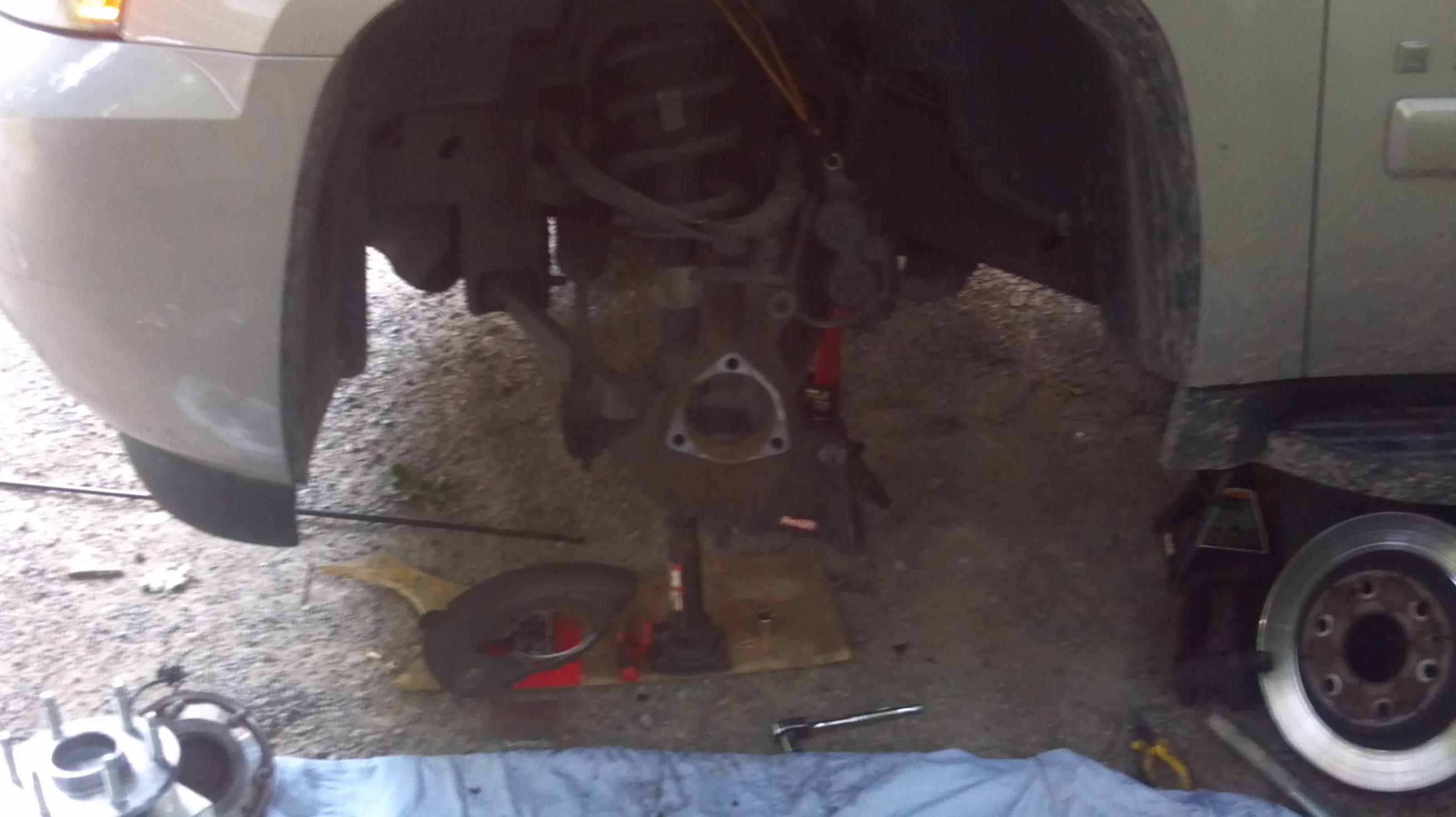

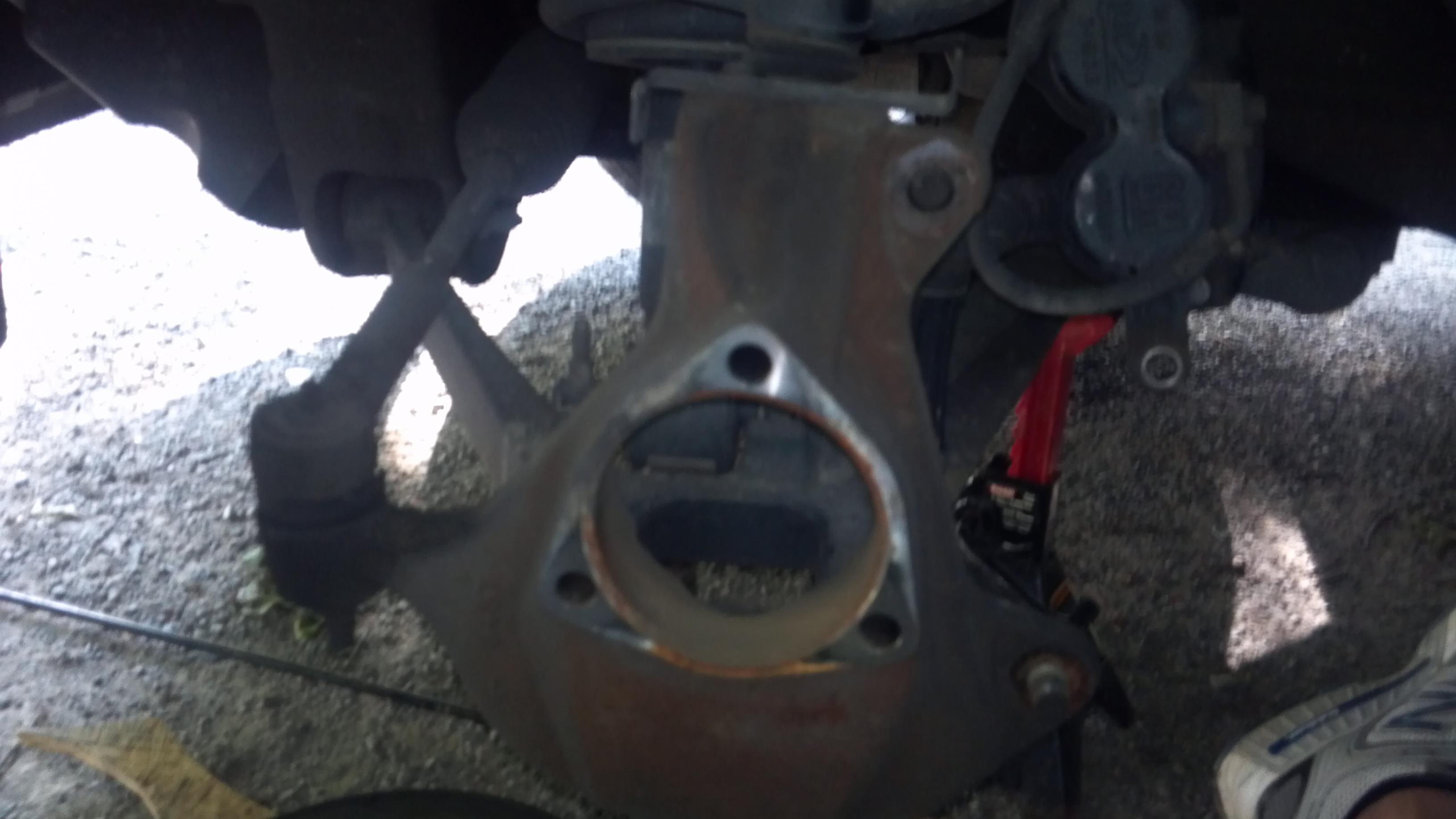

Fellas, thought I'd pass on some info. I found the issue with my wife's Burb. Front LH hub assembly gone bad. The replacement was a heckuva lot easier than I had originally anticipated (I've got pics if anyone is interested). I did however encounter a problem after the install. The "service traction control" and "abs" indicators are now showing. I disconnected the negative battery cable in the hopes that a reset/relearn would take place....no luck. I checked the sensor's connection from the hub assembly and it appears to be firmly connected. Any ideas or advice? Thanks in advance.
