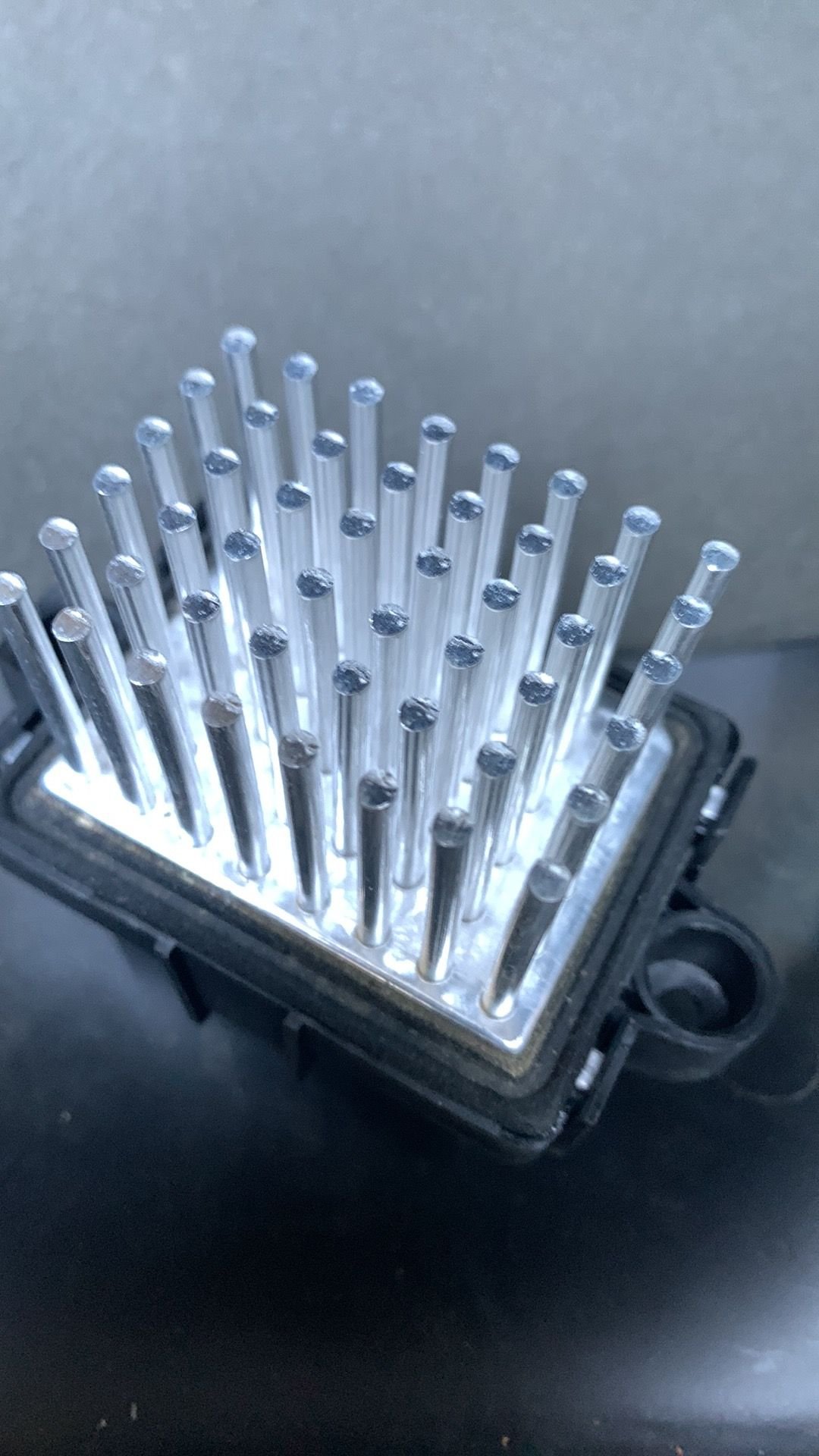

  1. Replaced the blower fan
  2. Replaced the resistor
I will be replacing the actuator under the passenger side to see if that fixes problem #1.

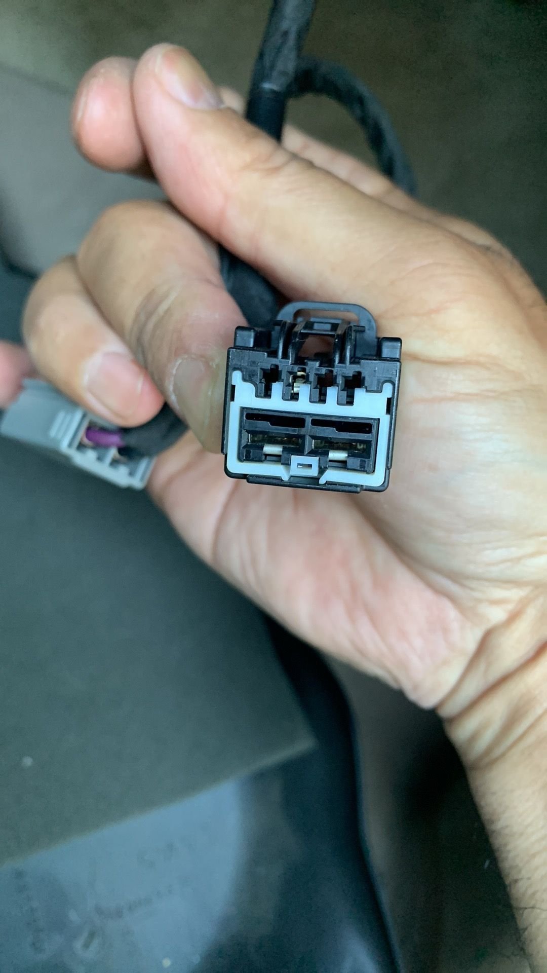

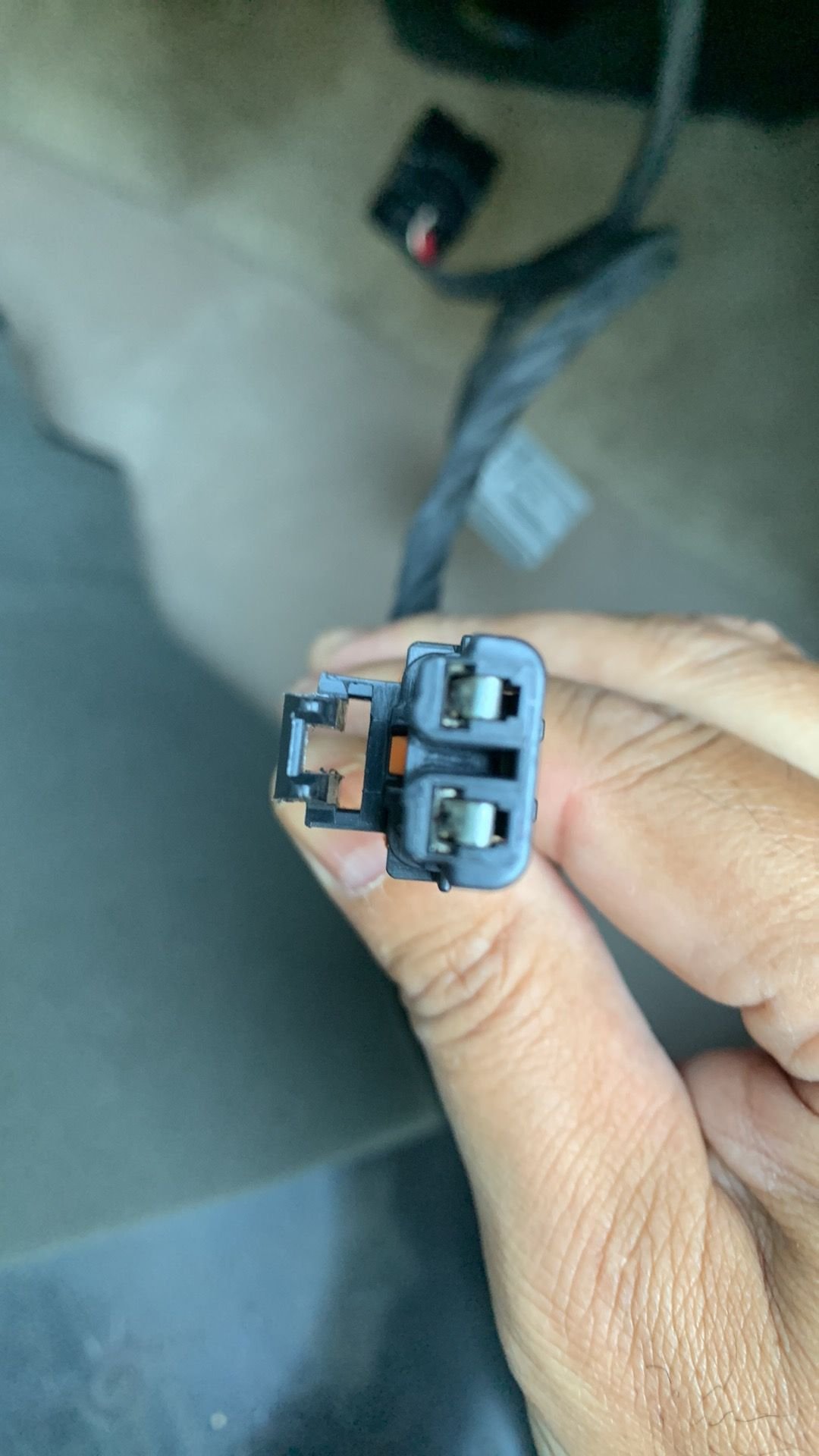

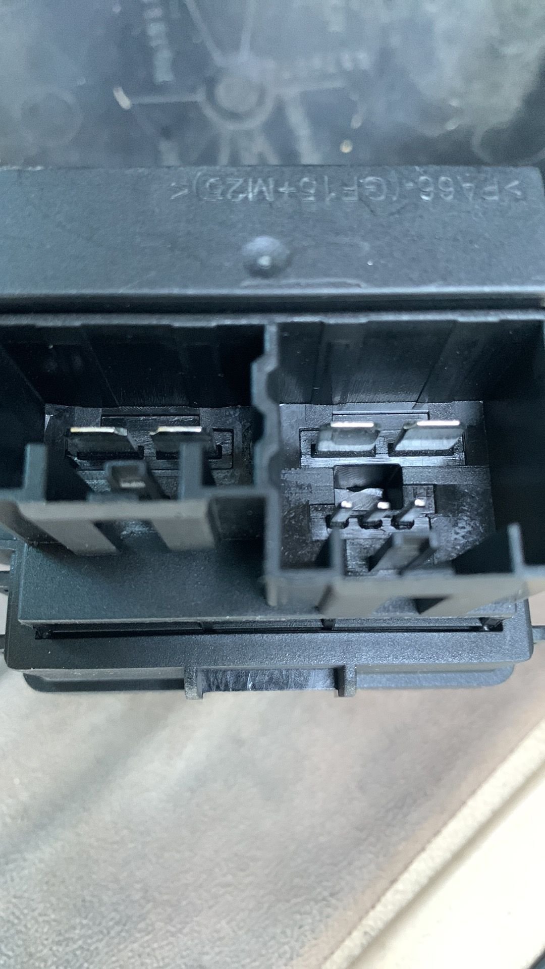

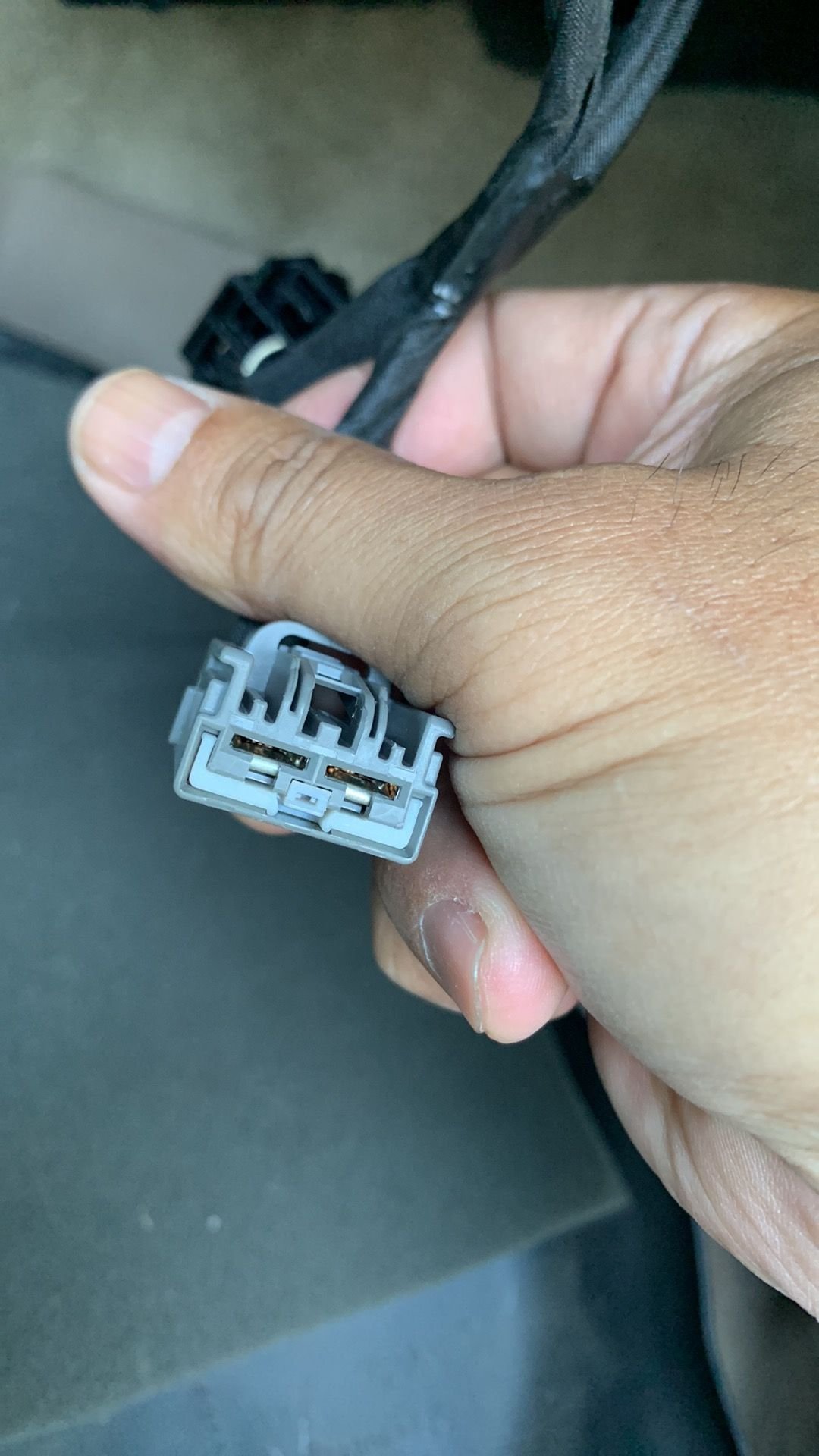

I also have the cable that goes from the blower fan to the resistor BUT there’s isn’t ANY obvious sign of burn marks. all connection points are super clean.
I know people have had similar issues so i’m hoping someone can shed some light on this. i’ve been chasing this problem for a few months now and want it fixed before summer comes.

So I think it's FIXED! Only time will tell but I figure I would document it just in case it helps someone else out.
I had 2 symptoms:
  1. The blower fan would cut in and out suddenly. Mine was happening when I would come to a stop. No idea why! Sometimes it would do it 2-3 times but other times it would do it like 10 times.
  2. Blower fan would get insanely loud and no flow from the front vents. This usually happened after a 30-45 min drive. It would operate normally after a 30-45 min stop.
NOTE: AC temperature was never an issue. When it was working the AC was COLD and HOT worked fine too. The modes all worked fine too. Although I was hearing creaking noise from the actuator so I replaced it anyway.
The Fix:
  1. Even though I replaced the resistor about 6 months ago, it went bad. It took me a while to figure out that this was the issue since I just replaced it. BUT this time I bought an AC DELCO (Bosch) Resistor (P/N 1581931) not a cheap one on Amazon. This fixed the first issue of the blower fan cutting in and out. Also note that the Blower Motor Wiring Harness (GM 15-75221) that goes from the blower fan to the resistor can also go bad (burn out) so check that as well.
