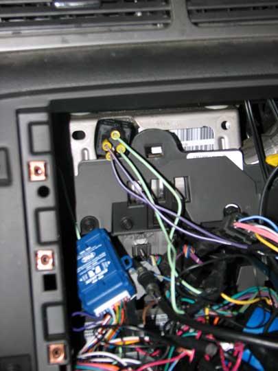

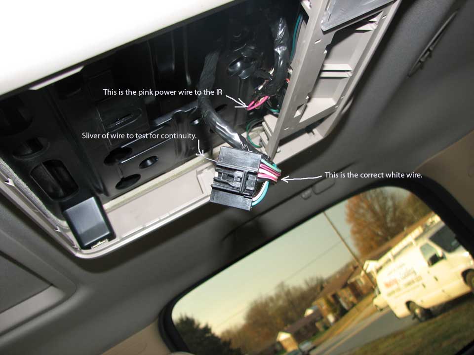

I was only able to get the DVD screen to drop down. Never was able to dislodge the IR transmitter but luckily enough I only saw one pink wire. There was however 2 white wires. I ohmed out the wiring harness until I figured out the wire that was coming up from the harness. I then soldered a 3 inch lengthof wire to join the two wires and insulated off the now cut supply pink wire that was cut away asyou instructed.
As an addition to your directions I used the blue/white wire heading to that particular white wire in the black harness as it was much easier to get to when the harness was unplugged. I made up the wires as you instructed and attached the small relay with enough wire to plunk into the cavity behind the radio after I insulated it. The amount of space on this particular installation was prohibitive. I did test the reverse camera (uninstalled) by plugging it in and it came right alive going into reverse. It does have some setup required in the Kenwood but it's fairly intuitive. Everything worked and the sound did come quitealive in the wireless headphones. Very satisfying... Crutchfield was supposed to call me back today with their go ahead but never did.
Thanks for everything Shawn and please send me a message with your address. I'm only buyingyou lunch so don't get too excited. But I tip the worthless waitress at Denny's so why not someone who's actually helpingyou when they're not getting paid for it. I will post the pictures of the screen drop and the relay sitting in it's hole behind the radio.

The wires showing after LCD removal and which ones to use. (The sliver of wire shown inserted into the front of the plug was used to ohm out to the connection behind the radio to make sure which white wire was correct.)

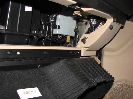

The factory XM Tuner behind the glove box which I removed and put the new tuner in it's place.

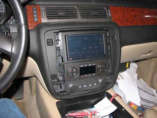

And the install almost done look minus the trim.
