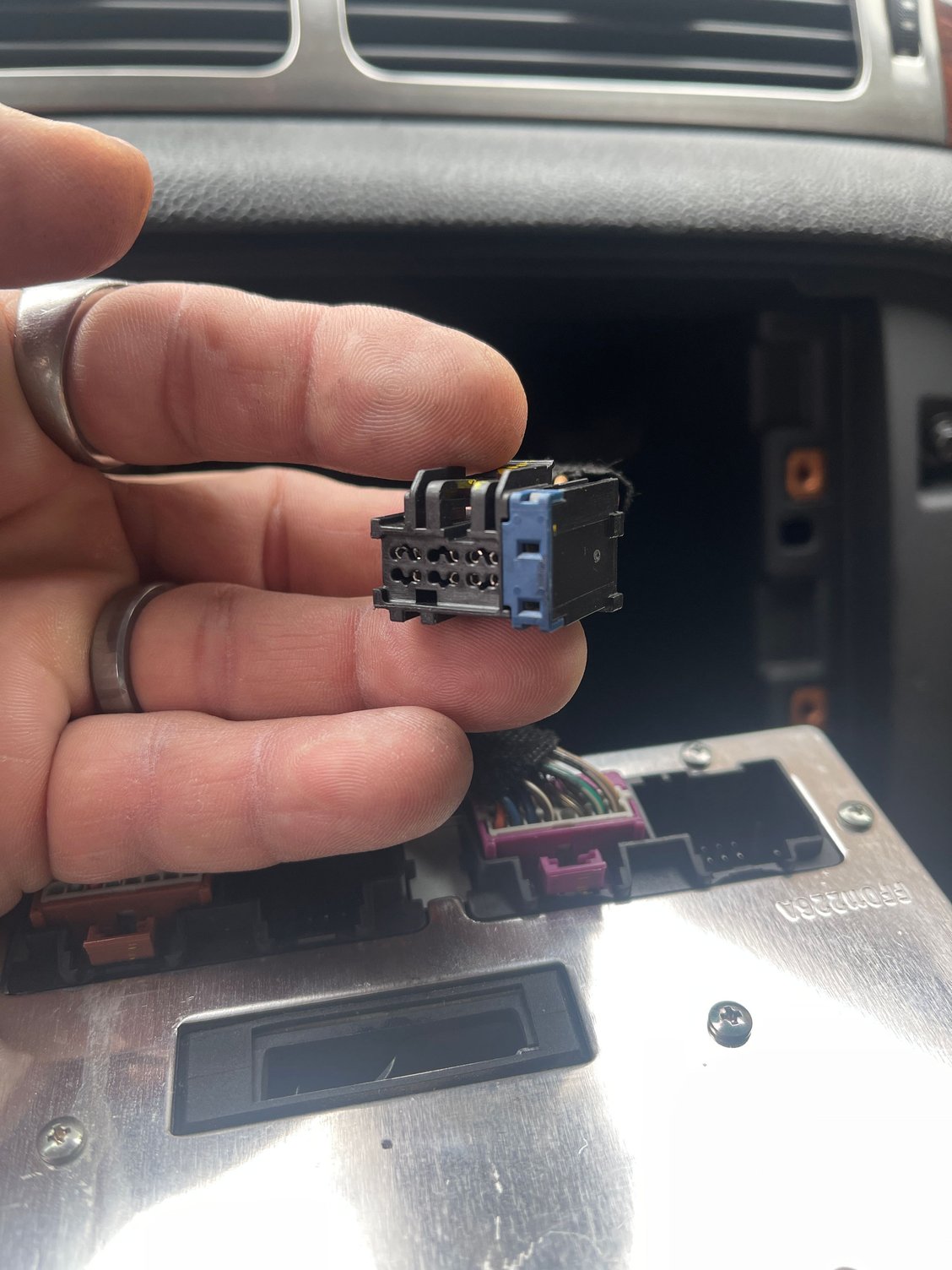

Look behind the radio . As you pull it out lay it face down. The plug to the right unplug it. has a side with a blue plastic cover (red and white line and a blk wire) there is your draw. It kill my battery every two the three days. Hopefully this will help others.
Here is what that looks like
