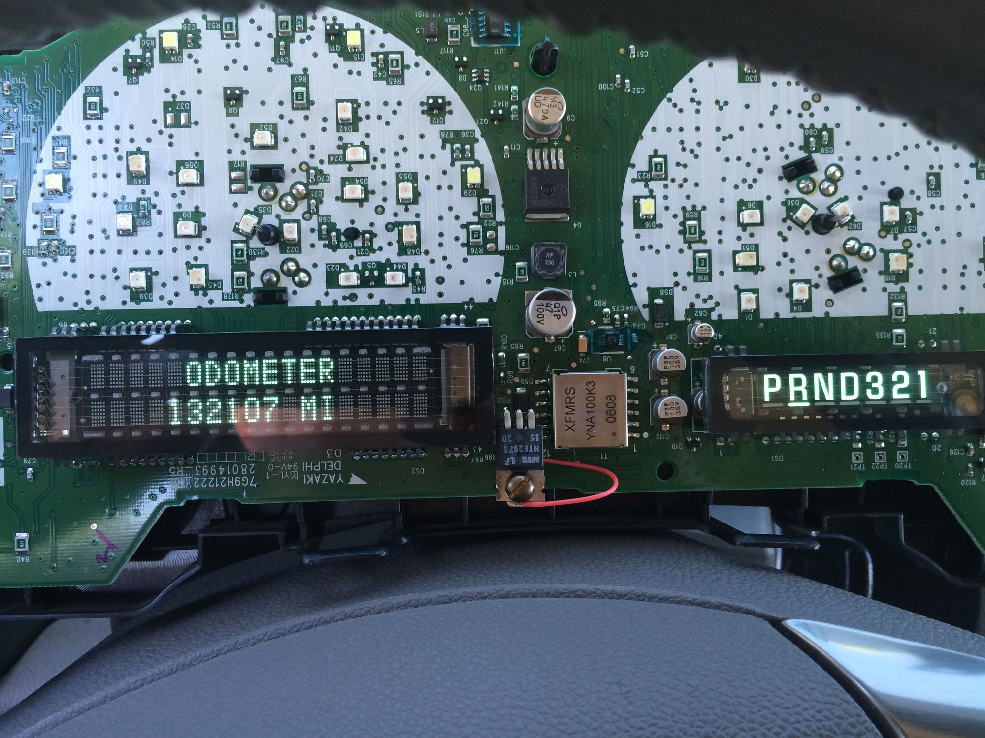

Q16 at bottom center with orange wire attached
Wow old news is great news! It was like finding a gold mine this forum and thread. Have a 07 Yukon bought last year for my wife, but because of health issues she doesn't drive. So we want to sell it. But the day we brought home the DIC went blank so we took it back to dealer (Ford) and they replaced the 4 switch stack to right of DIC. This fixed it until about a month ago. I checked around on line and found this site and this thread. Blew me out of water! Want to thank burhead1 and lapugh21for their information and solution to problem. Shoulda got the surface mount (IRLL2705) but got same as burhead1 (NTE2975) and also attached wire from flat back and cut out white plastic bezel. It worked great didn't hafta get odometer reset. Thanks so much for this thread and forum and the great Americans that post here. Blessings to all and keep the shiny side up!

I've also been having this issue with my cluster. Thanks to this thread, I should have mine fixed today. I wanted to share this photo I took of the Q16 problem area.
