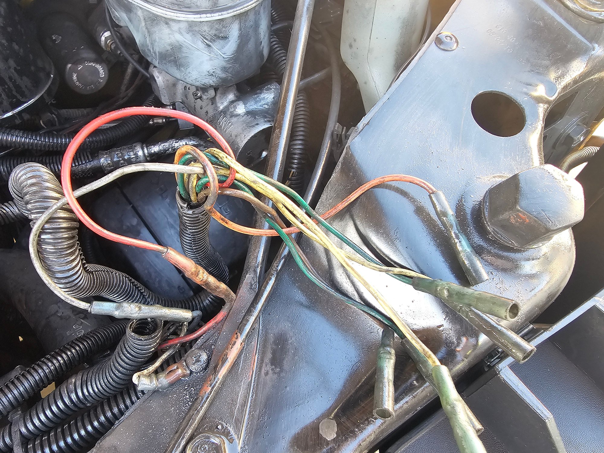

My van starter wont turn, but I have full battery power and car was running until I turn it off. I noticed a bunch of wires are disconnect, do you guys know what these wires are. They are in a bundle near the front bulkhead and a connector. See pictures

Likely for an old car alarm. Good luck rewiring your van.

My van is 2010 3500 Savana, I started it and the engine run..took it for a 20 miles ride and stop and turn of and when I crank..just silent..all other electrical system is ok. Anyone has a similar van and can see what those wires suppose to go. I suspect they came lose and cause the starting issue

https://charm.li/Chevrolet/2010/Expr...tem%20Diagram/
I guessed that you have a 6.0l but I bet the 4.8l is identical. The Duramax is likely different.

I'll bet those wires have been that way for a long time and are not the issue

So what happened is that I make a copy of the original key and try that to start I didn't know that the original key has some kind of transponder that would allow the van starter to turn but if you make a copy you can still open the door and turn on ACC but the starter wont engage. My original key look very simple and flat and has no key fob but look like the transponder chip is embedded into the key handle. So now the van is starting just fine
