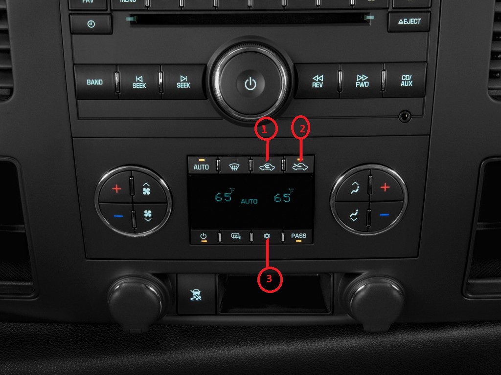

my silverado 2008 5.3 flex fuel engine. i want to know the location of the fuel filter?
and cabin AIR filter ?
and the time i should change them
when i use my A/C always switch 1+3 button,,, but when i want to use my in cabin cold air i switch off 3 ... i noticed that the A/C compressor still work ... is it normal ? how can i use cabin air with out use compressor ?

As for the A/C compressor behavior, it'll run when the HVAC controls are in the recirc, defog, or defrost mode unless it's freezing outside.

thanks guys...but if there is not A/C cabin filter what should i do to decrease bad air from out side any ideas???
Old May 12, 2012 | 12:04 PM
EinST's Avatar
Posts: 1,709
Likes: 5
I mostly use the recirc mode to keep the dust and exhaust fumes out.
