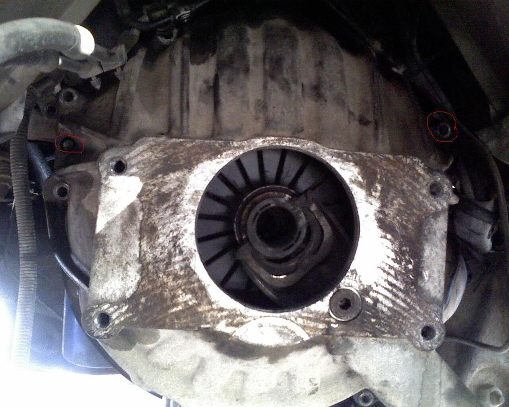

Im new here. Signed up because I cant get this stupid transmission off. I went to the dealership parts and they didn't anything. Other then having to buy new tools. Soo.... Just to be on the safe side. Can some one help me out here? This is what I got so far. Took off all the bolt I could see from the housing (dunno if thats how its spelled). But these two are the only ones left.
So, is there a special tool to remove these two? Tried my sockets but none of them fit. Will appreciate any help.
Thanks for view and helping
Jesse
PS This is a standard transmission on a 93 Chevy 2500.

Hi, im new to the forum also. Those are not bolts, those are just alignment dowel pins.

So ive taken all the bolts i could find and the housing still wont move im pretty much giving up and about to break the bitch off lol any ideas what might be the solution???????

Could the clutch fork be holding it by chance?
There should be 6 bolts holding the bellhousing in

soak em down with WD40. try to wedge a big screwdriver or pry bar in there and slowly work it side to side. Careful not to crack the housing though

ya its not just going to come off, you will have to work it off, try doing what shwnvw said, that should work, welcom to the forum

Thanks for the help, and sorry for the late reply. Now I have another question. I got the bellhousing off. All I had to do is pwn it out. But now question is, how do we bleed a hydro clutch?
