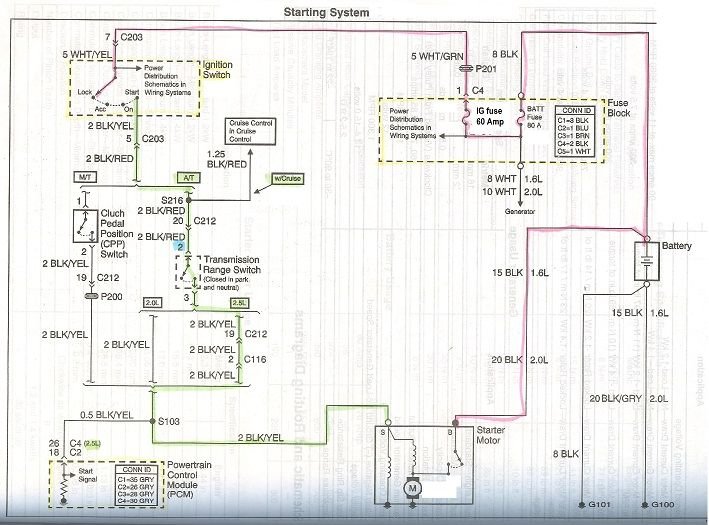

Trace the current path from battery positive to battery negative and you will see the only "clicking" component
is the starter motor solenoid. If it clicks every time, your switches and wiring are good. The problem is in the starter.

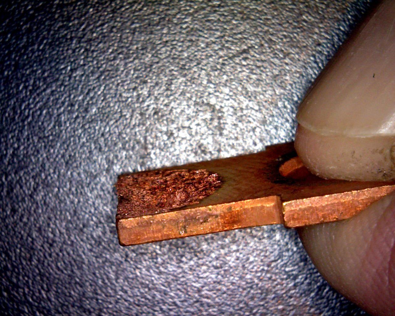

The most likely cause is pitted contacts on the "clicking" relay inside the solenoid.
Pitting causes a poor connection. Voltage is equal to current times resistance. The starter draws the most current of any device in the car. So even a small resistance in the solenoid contacts will produce a significant voltage drop. If your battery is 12 volts and you're losing 6 volts across the contacts, you only have 6 volts left across the starter motor. The motor will not turn. You will hear a "click" and nothing else will happen. There is no easy way to test the contacts on the car. You might narrow down the problem by gently tapping on the solenoid with a wooden broomstick handle instead of rocking the whole car. You might even be able to tap the solenoid while some one else holds the key in START. If the starter (motor and bearings, etc) is good, you can pay a starter repair shop to replace the solenoid. I did that recently on my Tracker.

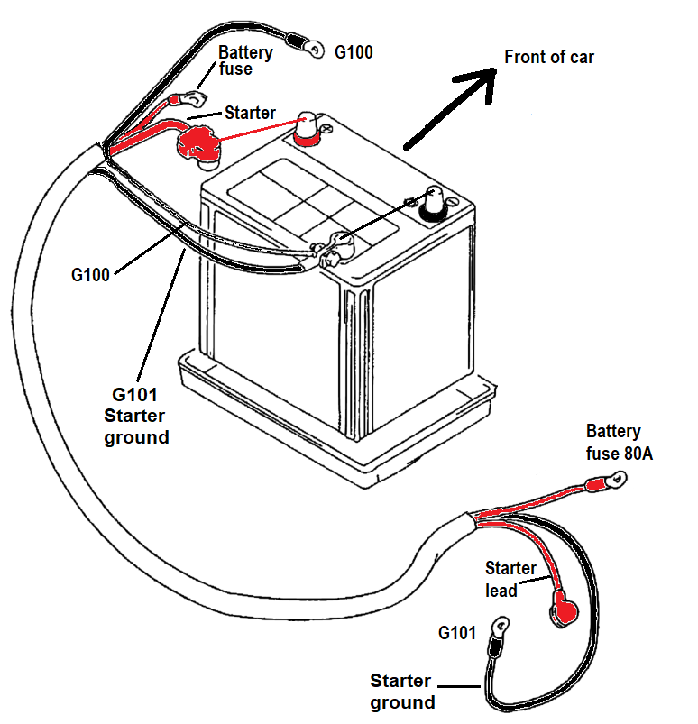

Earlier you said "I hear a click from the starter area." Let's investigate that first. Place a finger on the starter solenoid body and have someone turn the key to START. Can you feel the sound coming from the solenoid? If you can, the ignition switch is not the problem. If the starter has been ruled out, the next most likely issue is a poor connection between the battery and the starter. Earlier you also said "I completely pulled the battery connections apart and cleaned them." So if the battery connections are clean and tight you may have an issue where the battery cable connector attaches to battery cable's copper wire.
It is not uncommon for corrosion to build up at the connection.
There are four starter connectors -- two on the positive, two on the negative. While some one holds the key in START, wiggle the wire going into each connector. If the starter fires up you've found the problem.
