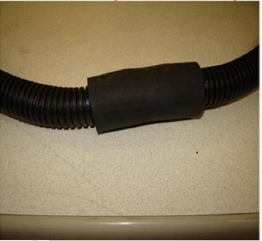

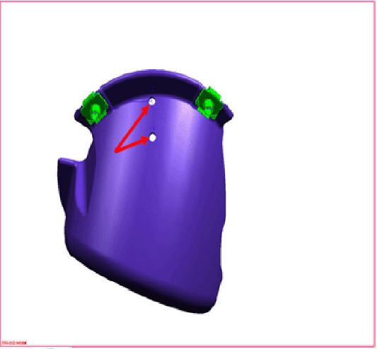

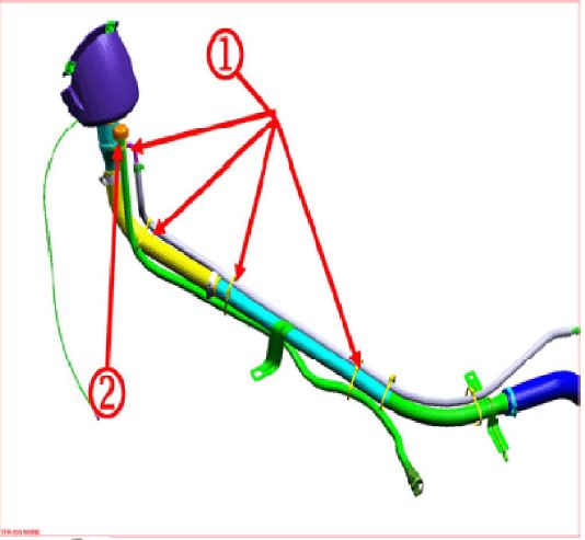

Default P0446 P0442 P0455 pressure purge solenoid tank vacuum vent
You may still have to replace the vent valve if it has become contaminated but here is a possible cause to the failure(s)
2007 Chevrolet Tahoe - 2WD | Avalanche, Escalade, Suburban, Tahoe, Yukon (VIN C/K) Service Manual |
Document ID: 2187902
#PIT4347F: SES MIL Evap DTC And/Or Hard To Fill -
keywords emission engine evap evaporative fuel large
leak P0446 P0442 P0455 pressure purge solenoid tank
vacuum vent - (Sep 11, 2008)
This PI was superseded to update model years and provide external fix. Please discard
PIT4347E.
The following diagnosis might be helpful if the vehicle exhibits the symptom(s) described in this PI.
Condition/Concern:
Some owners may comment that the SES is illuminated and when checking for DTCs the ECM will
have set an Evap DTC. While performing normal diagnostics it may be noticed there is excessive
moisture/water/corrosion at the vent valve solenoid, vent valve pipes, and/or EVAP canister. The
vent valve solenoid draws fresh air from near the top of the fuel filler pipe. In some situations, it is
possible that water spray from the rear wheels may be drawn in though the vent valve pipe at the
Recommendation/Instructions:
GM engineering is aware of this concern and working on a GM service kit to correct this concern. In
the mean time, the kit can be made from readily available parts and using the following procedure
below:
Parts List
Subject: SES MIL Evap DTC And/Or Hard To Fill
Models: 2007-2009 Cadillac Escalade, ESV, EXT
2007-2009 Chevrolet Avalanche, Suburban, Tahoe
2007-2009 GMC Yukon, Yukon XL, Yukon Denali, Yukon Denali
XL
Part
number Description Qty
15844701
evap vent inlet hose ¾" Heater
Hose
¾" Heater Hose 2.5" (6.3cm)
98755K24 Inlet Screen 1 ( © 2012 General Motors Corporoabtitoani.n A flrl orimgh tMs rceMsearsveted.r Carr Supply 1-330-
Document ID: 2187902 Page 1 of 5
1. Remove the existing vent hose "mushroom cap" (2) and zip ties (1), as shown below.
2. Add 31" (79mm) to existing snorkel hose using a length of hose taken from P/N 15844701.
Join hose sections together with a 2.5" length of ¾" heater hose, as shown below.
3. Slide inlet screen (98755K24) over the end of the new hose section.
4. Remove Fuel Filler "Sugar Scoop" from vehicle.
5. Add holes to "Sugar scoop" to retain inlet hose, as shown below.
995-5500)
8650K112 Acrylic/PVC sheet material
1 (obtain from McMaster Carr Supply 1-330-
995-5500)
Zip Ties As needed
Document ID: 2187902 Page 2 of 5
6. Fabricate splash shield from Acrylic/PVC sheet material (8650K112), as shown below.
7. 1. 6.645 inches wide
2. 9.75 inches long
3. Use filler "sugar scoop" as template to locate one large hole for fill neck and 3 small holes
for mounting screws.
4. 45 degree cut 1.25" in from corner on each side as shown
5. Use a quart can to mark radius on two corners
8. Attach end of vent hose and screen with zip tie as shown and reassembly with fabricated
Document ID: 2187902 Page 3 of 5
splash shield between "sugar scoop" and fuel filler pipe, as shown.
9. Route new vent hose along fuel filler pipe and add necessary zip tie to retain hose.
